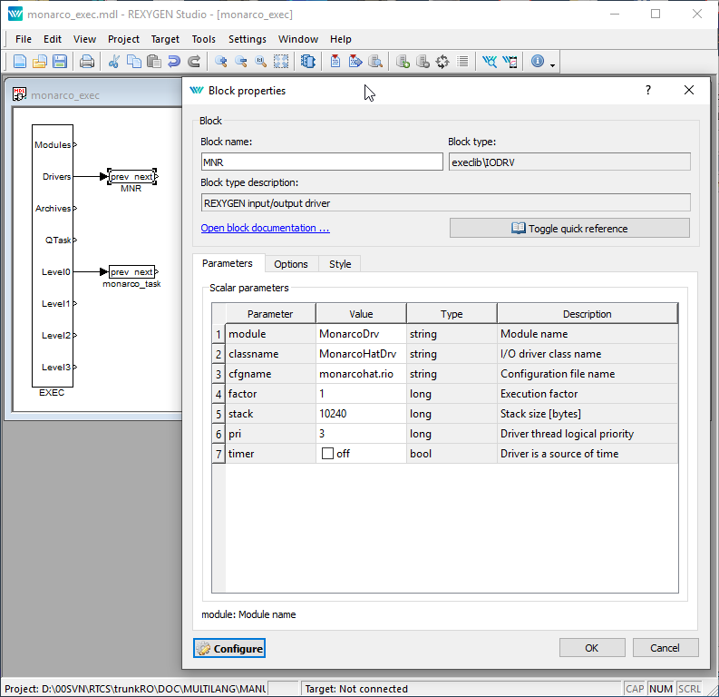

The project main file with the MonarcoDrv driver included is shown in Figure 2.1.
There is one block which must be added to the project to include the driver. A block of type IODRV renamed to MNR and connected to the Drivers output of the main EXEC block. The name of this block (MNR, see Fig. 2.1), is the prefix of all input and output signals provided by this driver. The four most important parameters are:
- module – name of the module linked to the driver, in this case MonarcoDrv – the name is CASE SENSITIVE!
- classname – class of the driver, in this case MonarcoHatDrv – the name is CASE SENSITIVE!
- cfgname – name of the driver configuration file, e.g. monarcohat.rio
- factor – multiple of the EXEC block’s tick parameter defining the driver’s task execution period
The above mentioned parameters of the IODRV function block are configured in REXYGEN Studioprogram. The configuration dialog is shown also in Fig. 2.1.
The Configure button opens the configuration dialog of the MonarcoDrv driver, which is described in chapter 2.2.

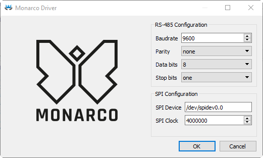

2.2 Configuration dialog of the MonarcoDrv driver
The configuration dialog can be activated from REXYGEN Studio by pressing the Configure button in the parameters dialog of the IODRV block (see chapter 2.1).
The RS-485 section configures the properties of the RS-485 bus for connecting to external devices.
IMPORTANT: Note that the internal communication between the CPU and the MCU of the Monarco HAT uses UART communication (/dev/ttyAMA0 on the Raspberry Pi) at 115200 baudrate, 8 bits per byte, no parity, 1 stop bit. These are the values you have to use in the Modbus driver configuration if you are willing to use it. For details about the internal structure of the Monarco HAT visit http://www.monarco.io.
The SPI configuration section defines the communication between the CPU and the Monarco HAT MCU (/dev/spidev0.0 on the Raspberry Pi, maximum clock speed is 4 MHz).

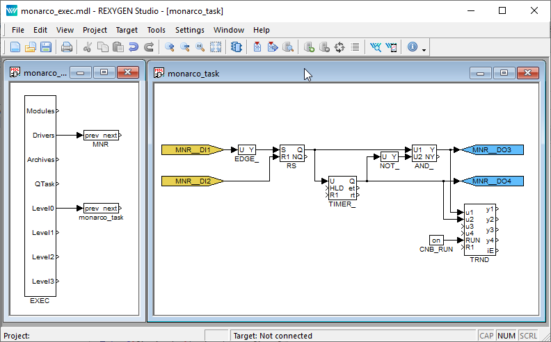

The inputs and outputs of the MonarcoDrv driver can be accessed as shown in Fig. 3.1.
One block of the From type allowing the user to read one input has the Goto tag set to MNR__DI1, while the other has this tag set to MNR__DI2. The number in the flag corresponds with the terminal pinout. The block of Goto type allowing the user to set (write) one output has the Goto tag) set to MNR__DO3, the other output is accessed via the MNR__DO4 flag. The blocks always have the MNR prefix right at the beginning of the tag followed by two _ characters (underscore).

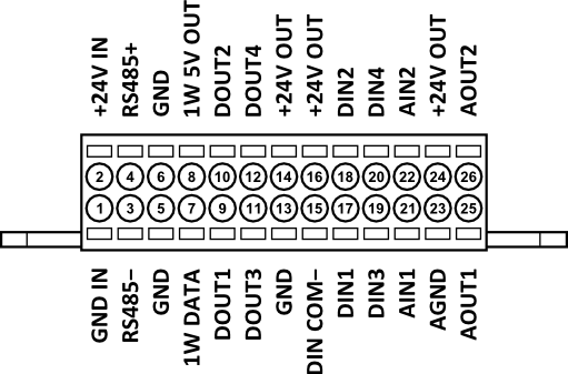

In general, the link to a particular signal consists of the driver name MNR, two underscore characters __, signal reference, signal number and an optional symbol defining the mode of the input. The terminal numbering of the Monarco HAT is shown in Fig. 3.2.

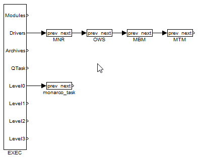

Figure 3.3 shows an example project main file with multiple I/O drivers.
