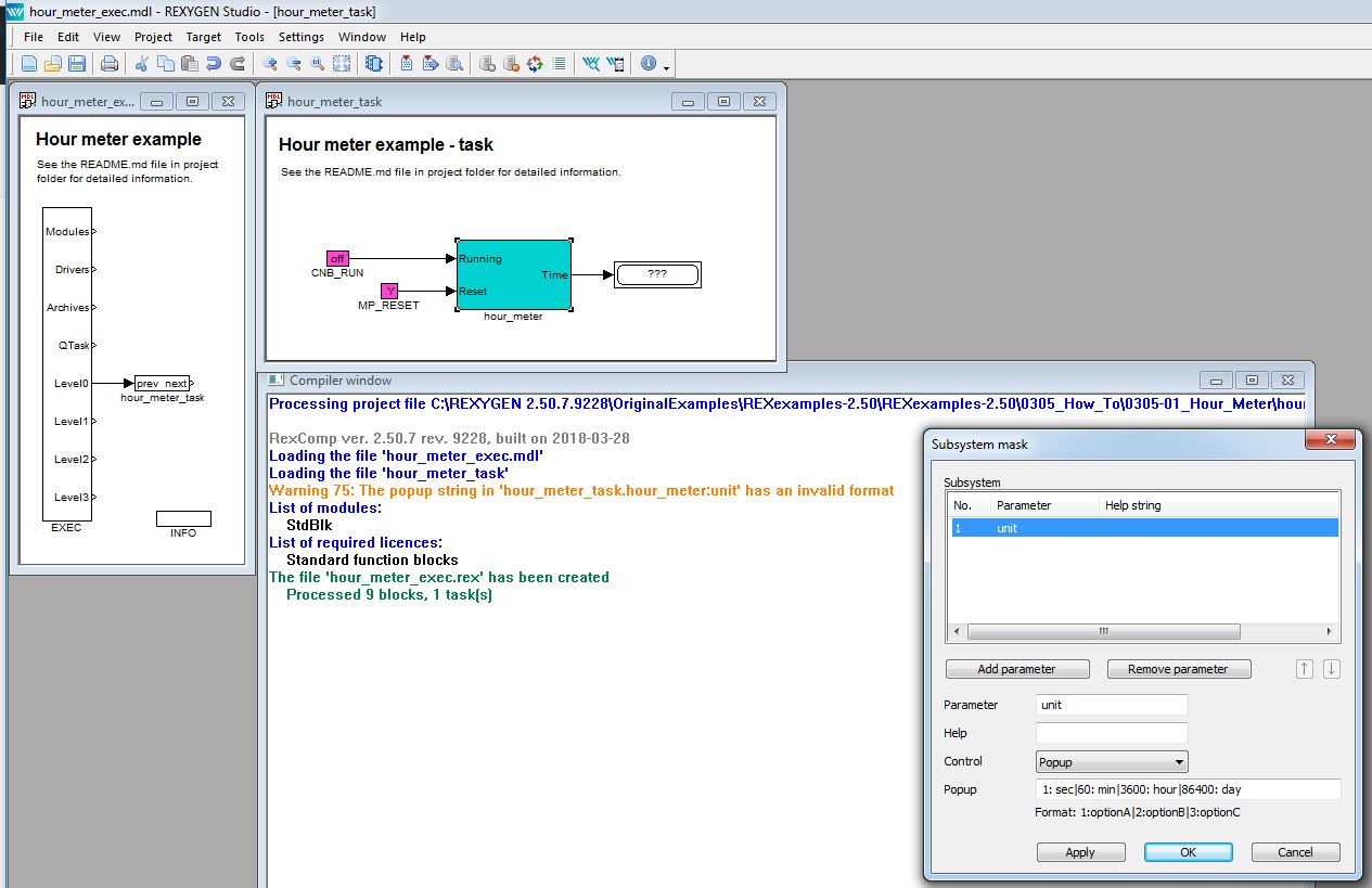

I observed that there is a problem with compiling the above mentioned example project.
The "popup string" appears to be incorrect.
Screenshot
I like to know how this should be setup correctly in order to use such a "hour meter" with different scales.

Hi Peter,
please find the corrected example project 0305-01. Thanks for reporting this.
The other part of your question can be solved by ticking the "Permanent" checkbox of the hour_meter subsystem and also of the INTE block inside the subsystem. That will make both the time scale and the hour meter value "permanent", i.e. they will be stored in a file on disk and they will be automatically loaded on startup. Default period of writing the values to disk is 5 minutes, i.e. in case of power failure your hour meter will be off by 5 minutes in the worst case scenario.

Hi Jaroslav,
Excellent, now I understand why it was not working before with this "selection-string".
And also the "Permanent" checkbox becomes more clear now to me.
