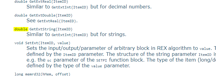

BTW, I also think that the following is not correct inside the REXLANG docu.

And thanks for spotting the copy-paste error in the documentation.
