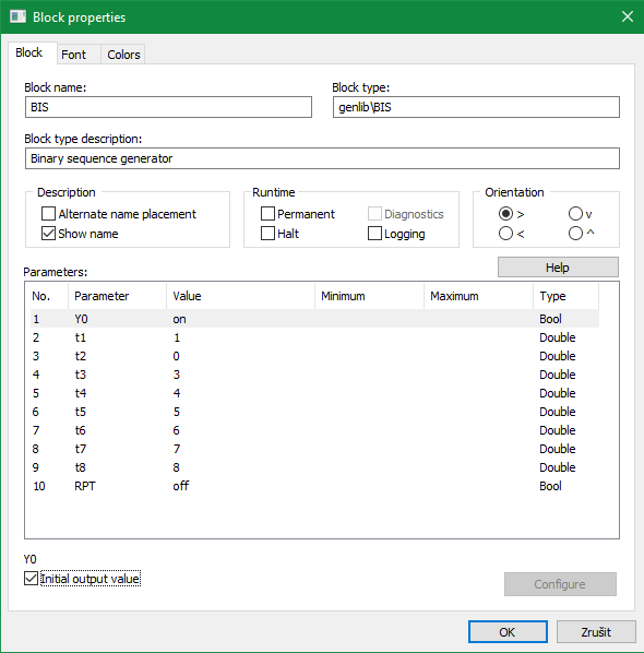

#4 2017-11-15 13:13:27
Re: EPC (EXEC) Run once at startup
Hi,
it is possible to use MP block. I often use BIS block setup as follows:
Hope it helps.

#6 2017-11-21 10:39:04
Hi,
the MP block cannot be used for such a purpose. MP stands for manual pulse and therefore it only reacts to manual changes in the BSTATE parameter. See the documentation of the MP block.
Whenever the algorithm is restarted, the blocks start from scratch. Therefore your use of the BIS block is correct, it will generate 1 second pulse whenever the algorithm is (re)started and it will repeat each hour.
If you need to generate pulses hourly, regardless of restarts, use the TIME block as a trigger.
