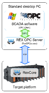

The standard installation package of the REXYGEN system development tools includes also an OPC server, which can serve as a data exchange point between visualization system (SCADA, HMI) and the running control algorithm.
There are many visualization systems of third parties, e.g. InTouch, Indusoft, Genesis, WinCC, Citect or Reliance, to name a few. Some of them are even free for personal and non-commercial use.
The OPC server of the REXYGEN system runs only on Microsoft Windows 10/11. It communicates with the REXYGEN target device via proprietary communication protocol and provides data exchange with the visualization software via the OPC protocol. The current version of the REX OPC Server supports OPC Data Access 2.0 and 3.0 specification. The visualization packages include a broad range of tools and graphical elements to process the data and the creation of professional and detailed visualization of the controlled technology is quite straightforward.

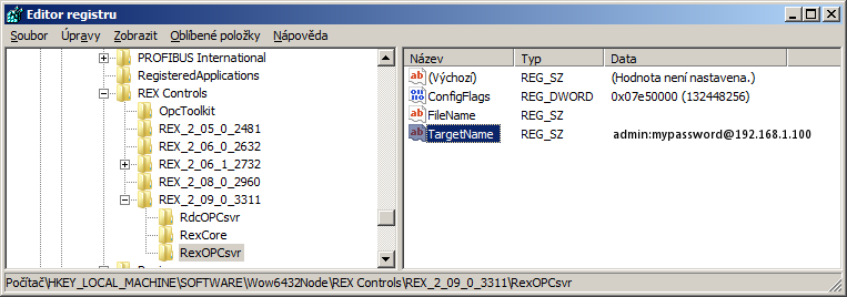

It is necessary to define the IP address of the REXYGEN target device in Windows registry
to allow data exchange with the OPC server. Find the following key in the Windows
registry
HKLM\SOFTWARE\Wow6432Node\REX Controls\REX_X_XX_X_XXXX\RexOPCsvr
and set the IP address of the REXYGEN target device into TargetName.
The address of the target device must contain a username and password for establishing connection with the REXYGEN runtime module on the target device. Please use the same credentials as you do in REXYGEN Studio. The syntax is e.g. admin:mypassword@192.168.1.100. If there are multiple devices the OPC server should connect to, use semicolon as a separator in the list.
It is highly recommended to password-protect your target device but you might have reasons for not doing so. In such a case use only admin@192.168.1.100.

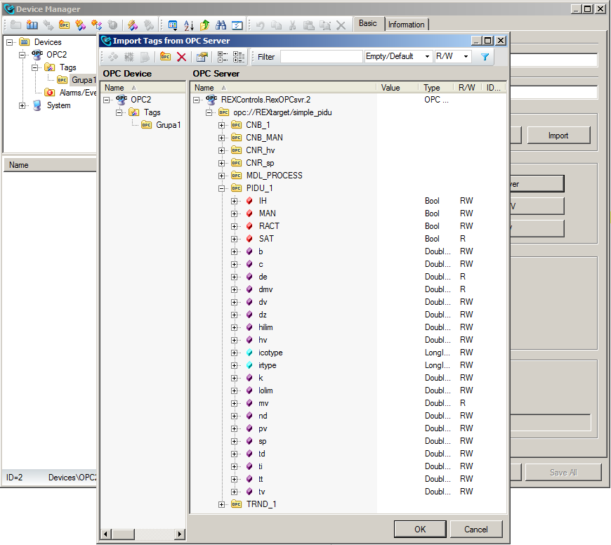

Afterwards it is possible to establish data exchange with the running executive of the REXYGEN system from the visualization software. The OPC server named REXControls.RexOPCsvr allows the visualization SW to read all inputs, outputs and parameters of the function blocks the control algorithm is composed of. It is possible to write to function block parameters and inputs. For the latter case, no signal can be connected to the block input in the control algorithm.

In the case you are able to see REXControls.RexOPCsvr server in the list but do not see the individual signals of the control algorithm, you probably have:
- incorrectly defined the IP address of your target device in the Windows registry
- disconnected the target device (check the Ethernet cable)
- switched off the target device
