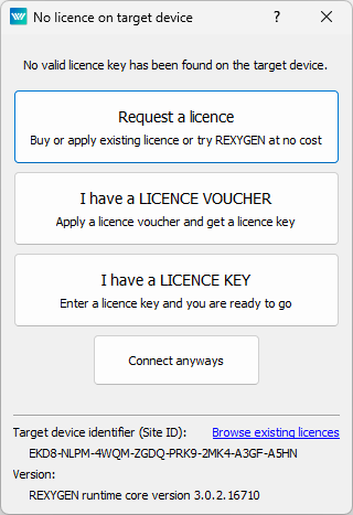

2.1 No Licence Dialog Window
If there is no active valid licence on your target device, upon connection a dialog window will appear with the following options:
- Request a licence
- – Allows you to purchase a permanent licence, apply an existing licence, or obtain a DEMO licence.
- I have a LICENCE VOUCHER
- – If you already own a licence voucher, you can redeem it here.
- I have a LICENCE KEY
- – If you already have a licence key for the device, you can apply it here. This option is suitable if you do not have internet access.
At the bottom of the window, the Site ID of the target device is displayed, the installed version of RexCore, and also the option to view existing licences in the browser directly on the licensing server page.
If you do not have a voucher or a key available, you can request a licence directly from the dialog window using the Request a licence option. Internet access is required to use this option. If you sign in with your account (You can create a free REXYGEN account here), the following table will show not only available licences but also unused vouchers and licence keys for the device that are assigned to your account. If you choose to continue without an account, you will only see available DEMO licences and links to purchase permanent licences on the eshop. Whether you are signed in or not, you should see the dialogue window Get a licence key with a similar offer as shown in the image below.

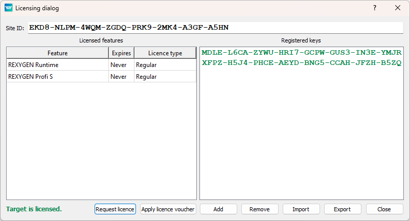

Before applying the licence voucher, remove all existing DEMO licence keys using the window described in Chapter 2.4. Then, simply follow the instructions that appear after selecting I have a LICENCE VOUCHER in the window described in Chapter 2.1. After applying the licence voucher, a SiteKey licence key is generated and automatically saved to your target device. You can check that the licence was properly loaded on the target device again using the window described in Chapter 2.4.

2.4 Licence Management
You can manage your licence keys using REXYGEN Studio. When you are connected to the target device, select from the menu Target Licensing to display licence keys and activated modules. Here, you can see all activated licences and modules. You can add new licence keys, remove existing ones, import and export complete lists, or apply licence vouchers.

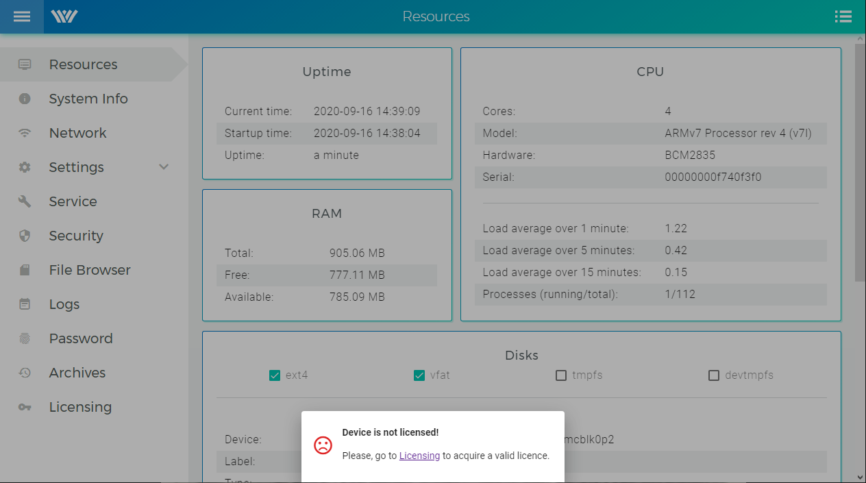

REXYGEN DWM is a web tool that you can use, among other things, for easy licensing of your target device. Details about the tool can be found in [2]. If REXYGEN DWM is installed on your target device, open your web browser and enter the IP address of the device. You should see the message Device is not licensed! at the bottom of the screen. Please click on Licensing.

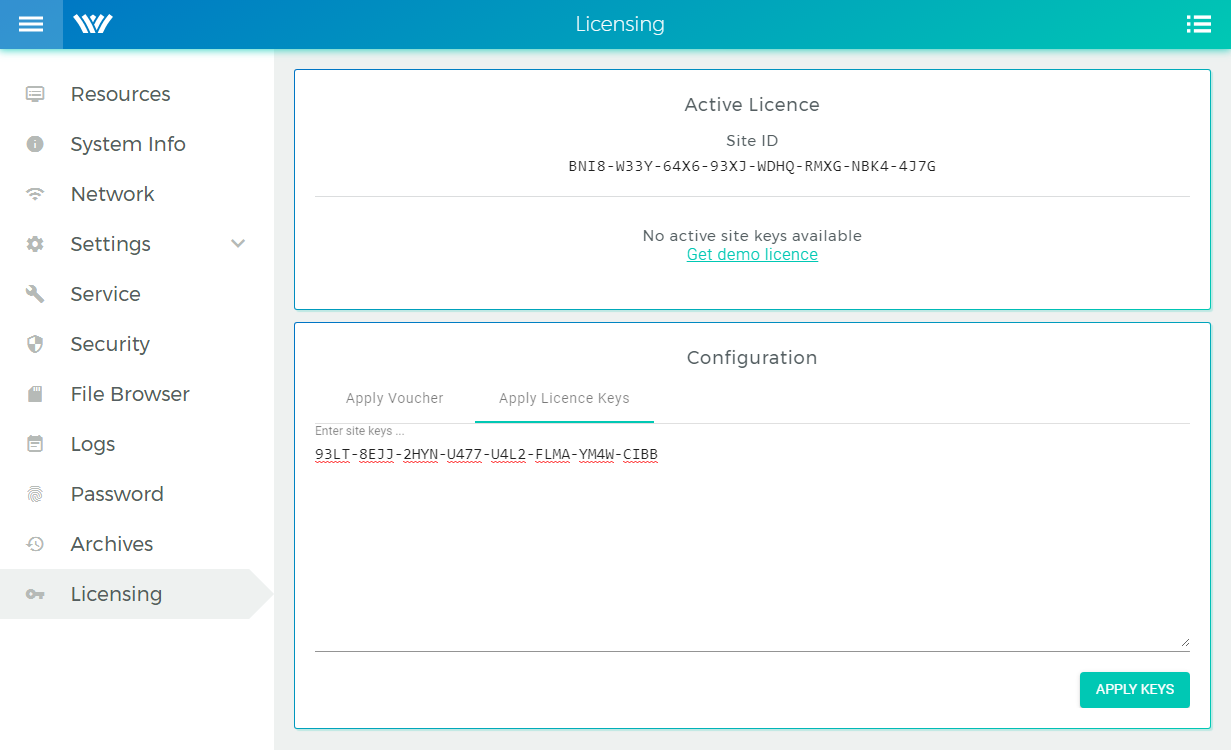

To obtain a DEMO licence, click on Get demo licence and you will be redirected to the licensing server. Fill in the registration form, and a confirmation link will be sent to your email. After confirmation and validation, a licence key (SiteKey) will be displayed, which you can use for testing.
Once you have your DEMO licence key, use it in REXYGEN DWM by selecting the option Apply Licence Keys and clicking on the APPLY KEYS button.

In REXYGEN DWM under the Licensing tab, click on Apply Licence Voucher and enter the licence voucher. After pressing the APPLY VOUCHER button, the licence key will automatically be generated and saved to the target device. If other licences are already present, a new window will appear where you can specify what should happen with the old licences. Use the Overwrite option if only a DEMO licence is on the target device.
