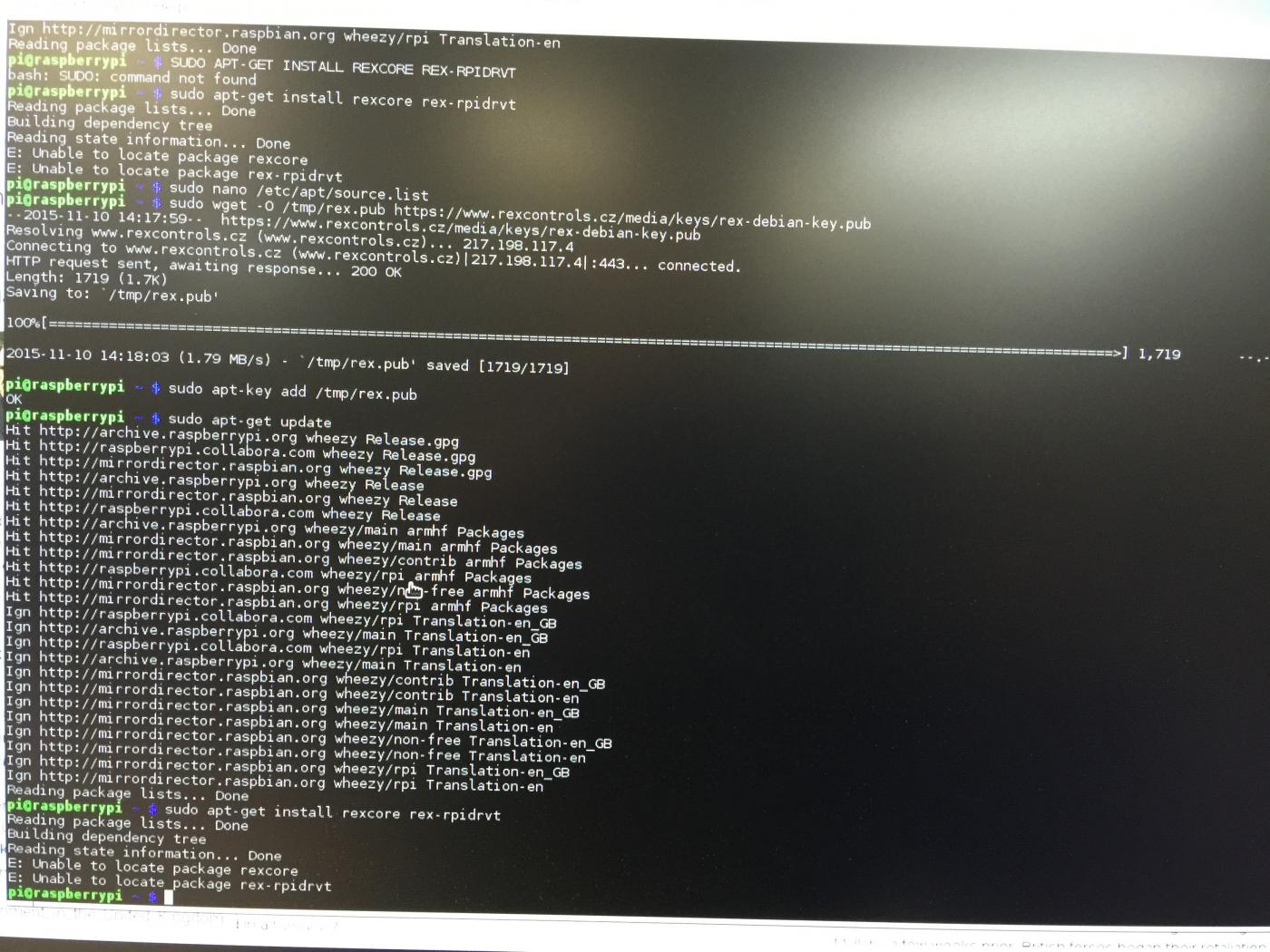

#8 2015-11-10 15:52:02
darrenhowton
Registered: 2015-11-10
Posts: 6
Re: Installing REX on Raspberry Pi
#9 2015-11-10 15:53:57
darrenhowton
Posts: 6
sorry for the delay had to do some work please see attach if this is not showing the section you want please let me know what command you would like me to run and i will send you the screen shoot
#10 2015-11-10 15:57:11
You need to add the package repository to /etc/apt/sources.list, not /etc/apt/source.list.
