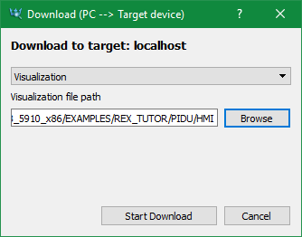

1. Open "exec.mdl" in RexDraw, Compile and download (F6) (make sure to check "Start local RexCore if necessary" and also uncheck "Save the new configuration permanently" - if you don't have Administrator rights).
2. Open RexView and download HMI to target: Target / PC --> Target device...
3. Run RexHMI services (shortcut in Start menu Rex Controls folder)
4. Open web browser and fill in address 127.0.0.1:8008 and you should see the visualisation.
