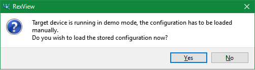

When you restart the machine without a licence the RexCore process will be running but without active executive loaded. You can connect with RexView and you will be asked:

It is enough to restart RexCore:
sudo /etc/init.d/rexcore restart
or
sudo service rexcore restart
Still it is necessary to start the algorithm manually, either from RexDraw or RexView.
