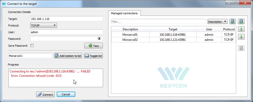

I was succesfully working with Rexygen for some while on a Raspberry Pi with MonarcoHAT. But now all of a sudden, I'm getting this above listed error message "Connection refused (code -413)".
I tried with a second RPi with MonaroHAT, but am facing the same problem.
Everything was working before, but now I'm facing this problem.
I can "ping" both RPi's without problem.
Would it be possibible that an automatic update of Windows or an update of a virusscanner would have caused this problem to appear?

Hi Peter,
"Connection refused (code -413)" means that RexCore is not running on the target device, i.e. nobody is listening on the other end of the communication line and that's why the connection is refused.
Please follow the instructions on restarting RexCore.
Let me know if this helped.
Kind regards,
Jaroslav

Hi Peter,
the error "Connection refused (code -413)" means that the target device was reached, but it has actively refused the connection. See e.g. this explanation.
I still believe the problem is in RexCore, which crashes for some reason. At least I do not see RexCore among your processes listed by "ps ax".
Please try to remove all *.rex files from your Raspberry Pi as advised in the Knowledge base, restart RexCore and try to connect from your PC in the office.
If this solves the problem, you have found a serious bug and I'd love to have your project files which are causing RexCore to crash so we can debug it and trace the root cause. Please let me know.

Hi Jaroslav,
I found out what was going on!
The ModBus driver all of a sudden had an incorrect IP address listed (something like 127.0.0.1 or something like that.
I changed ONLY that to the correct IP address and I could load it without a problem.
After I tried changing it back what I thought was listed above, so 127.0.0.1, it also worked again without a problem.
Too bad that I did not have made a copy before changing this.... :-(
But anyway that was the only thing apparently.
Sorry for not being able to forward it now to you in a NON working order...
Best regards,
Peter
