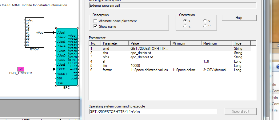

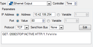

I am dealing with HTTP requests again and to be honest I do not have a lot of experience in this. I will receive the following request "GET /200ESTOP1ActiveHTTP/1.1\r\n\n" from a controller (Client) - see attached.
I want to use the EPC block to convert this into something useful - see attached. Please advice.Capture.pnghttp.png
#7 2016-10-05 14:53:41
Re: http request
Hi Hendrik,
as far as I understand, the zWay acts as a server, which provides data to clients. You should be issuing HTTP GET commands. Try reading the data from RPi command line first. Something like this should work
 wget http://YOURIP:8083/ZWaveAPI/Data/* -O -
where you need to use the IP of your RPi and replace the * with any meaningful path (I have no experience with zWave, sorry).
Once you are able to retrieve the data from command line, you can use the EPC block to do this job for you.
PS This will be much easier in the new version of REX, but still you need to know how to retrieve the data from command line.
