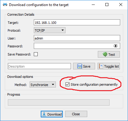

PFC100 needs to re-download after power cycle

I have noticed that if I switch the power off and on to my PFC100, I need to re-download the project to the device to get it working again; i.e. it seems to have no control functionality after a restart. Have I missed a setting in the WAGO configuration?

did you check the "Save permanently" option in the download dialog of REX?
Default bahavior is that the program is downloadded to RAM only, because that's the limitation of DEMO version. With a valid licence, you should tick that option, which stores the program in the internal storage and then it starts on boot automatically.

That worked. Thank you very much. I should have spotted that myself really.
