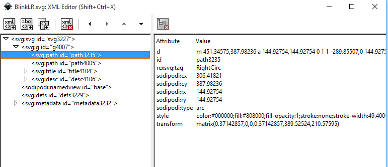

I noticed that I do not have an attribute called rexsvg:module. In my Inkscape object it is called ns0:module, did I missed something?

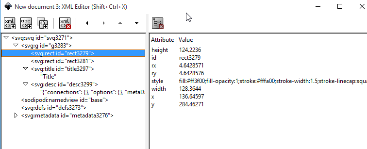

Here an the XML of the example with the rexsvg:tag......
Here the XML of my own created object but this one doesn't get the same tags as the example.
Sorry, my fault. Use ns0:module and ns0:tag instead of rexsvg:module and rexsvg:tag. I have updated my previous post and the source files.

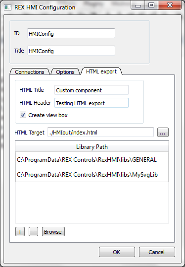

That's what I did, but when exporting to html the reference to my own library is not automatically inserted into the index.html file.
Did you leave the Library Path field empty?
If yes, all libraries from C:\ProgramData\REX Controls\RexHMI\libs should be added automatically...

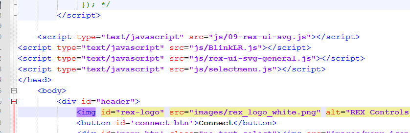

I exported with the same settings as you described above but it looks like that the paths for the libraries are not exported. It's only when I leave the field empty that the index.html file contains the path to the libraries....
The export works as it should, except the fact that your library is ignored for some reason. With empty Library Path, all libraries from C:\ProgramData\REX Controls\RexHMI\libs are exported:
<script type="text/javascript" src="js/rex-ui-svg-general.js"></script>
<script type="text/javascript" src="js/rex-ui-svg-home.js"></script>
<script type="text/javascript" src="js/rex-ui-svg-hvac.js"></script>When libraries are listed in Library Path, only the selected ones are included:
<script type="text/javascript" src="js/rex-ui-svg-general.js"></script>In both cases, the line with your library should be included:
<script type="text/javascript" src="js/BlinkLR.js"></script>However, it is ignored for some unknown reason and I do want to find out why. Thanks for your cooperation so far.

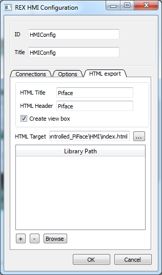

Yep, exactly. I can work around this issue but it would be nice that I can use my own libraries and that they are implemented automatically. (no rush as my own libraries do not exist yet...
What Windows are you using? Windows 10 Pro
What version of RexHMI extension are you using (Extensions->RexHMI->Version Info)?version 0.7.185
Can you try running Inkscape as Administrator and do both exports once again? see below
Can you please zip the whole folder C:\ProgramData\REX Controls\RexHMI\libs as you have it at the moment and upload it here? Link to REX-Controls.zip
exported files as administrator :
exported HMI with path to libraries
exported HMI with empty field (no paths to libraries)
I think I did the conversion to Windows 10 when REXControl was already installed, maybe I should try to remove the complete installation and start all over with a fresh clean installation?
(FYI : I was not able to copy objects out of the library into my project when Inkscape was started as administrator. So I prepared a project as normal user and exported as administrator.)
Thanks, now I understand. The problem is that you have your custom component in C:\ProgramData\REX Controls\RexHMI\libs\MySvgLib\BlinkLR. You have to move it one level up to the folder C:\ProgramData\REX Controls\RexHMI\libs\MySvgLib which is shown here:
Hope this is the problem. If you placed the component in the subfolder by mistake, then no problem. If some part of the tutorial convinced you to put the files in the subfolder, please let me know which one so I can make it more clear for other users.

Open the XML editor in Inkscape (Ctrl+Shift+X).
Find svg:g belonging to the newly created component (id="g2993" in the case of MyButton_src.svg file, it is inside another group, which is the mentioned wrapper).
Drag this group to the root object svg:svg so that it resides inside the so-called root level.
The remains of the original object (wrapper and also layer1) should be deleted - Delete node.
In the component being created change the value of the ns0:module attribute from "GeneralComponent" to "MyButton".
Find svg:rect (the rectangle, id="rect2985")..
Add the ns0:tag attribute manually and set it to "ButtonRect".
Find svg:text (the text object, id="text2987"). Alternatively it also could be an svg:tspan object.
Add the ns0:tag attribute manually and set it to "Label".
Find svg:title (id="title3000"), unfold it and change "Title" to "ButtonElement".
Find svg:desc (id="desc3002"), unfold and enter the description of the parameters of the component:

To include the component in the exported HMI, you have to move the folder with the component and the JavaScript code to the C:\ProgramData\REX Controls\RexHMI\libs folder (name the folder e.g. MySvgLib).
Now create the HMI in Inkscape just like you would with the standard components and export the HMI. Use testHMI-button.zip to test the component I have developed.
