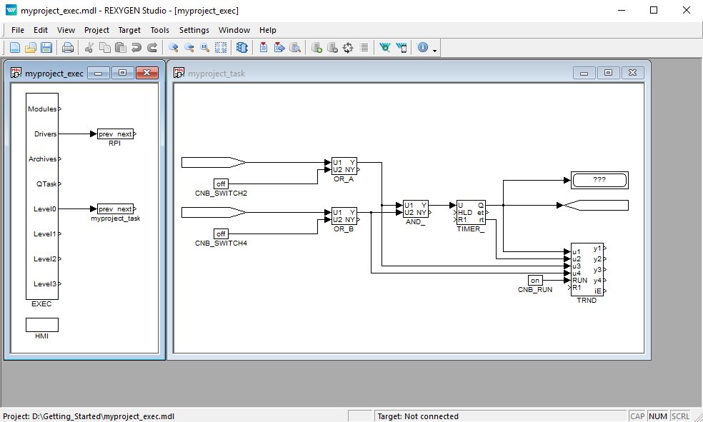

The process of creating a control algorithm will be demonstrated on a very simple example with four Boolean variables representing manual switches. In Chapter 5.3, two of them will be replaced by physical inputs of the Raspberry Pi. A software timer will be used for measuring the time when the variables are true (i.e. the switches are in the ON position). A Boolean signal will indicate that the interval of predefined length has elapsed.

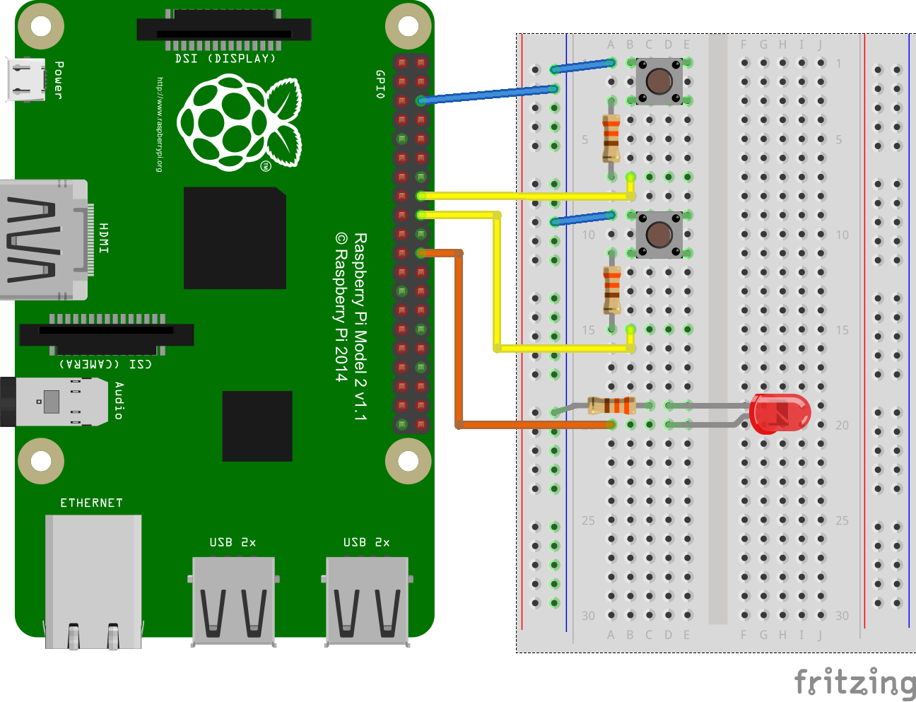

5.1 Physical connections
Connect the switches, protective resistors (330 Ohm) and a LED indicator as shown below.

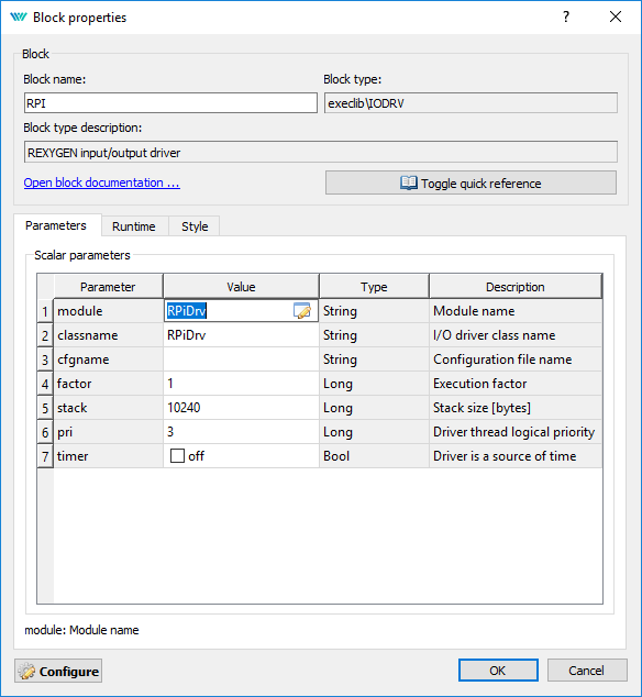

Now we tell the compiler to use the Raspberry Pi I/O driver. To do this, edit the IODRV block parameters. Link the IODRV block with the RPiDrv module by setting
- – CASE SENSITIVE!
Continue editing the IODRV block parameters. For bare Raspberry Pi set the following:
- – CASE SENSITIVE!
- Leave the cfgname parameter blank.
As the final step, rename the IODRV block to RPI, which will serve as a prefix for all I/O signals of this driver.

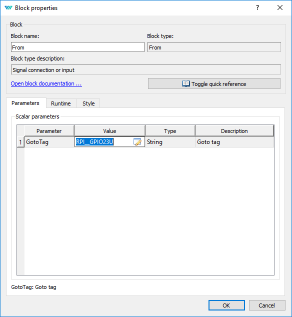

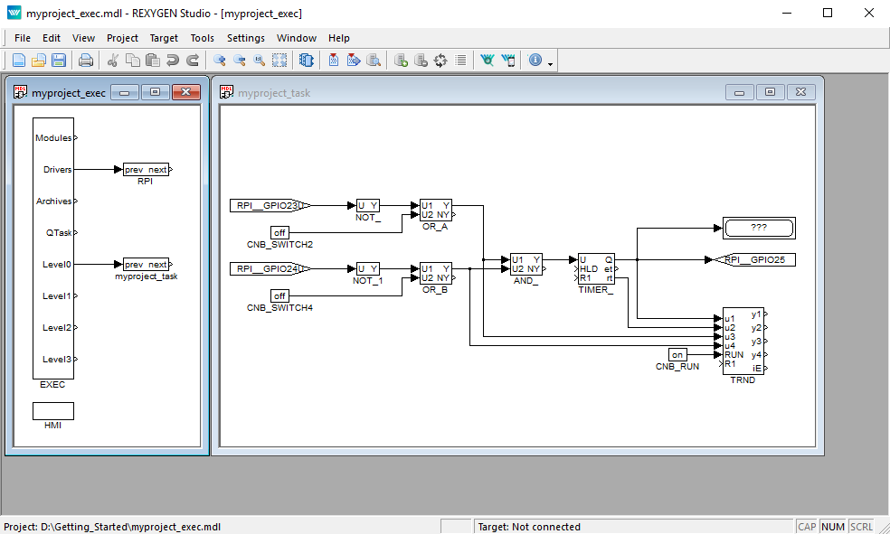

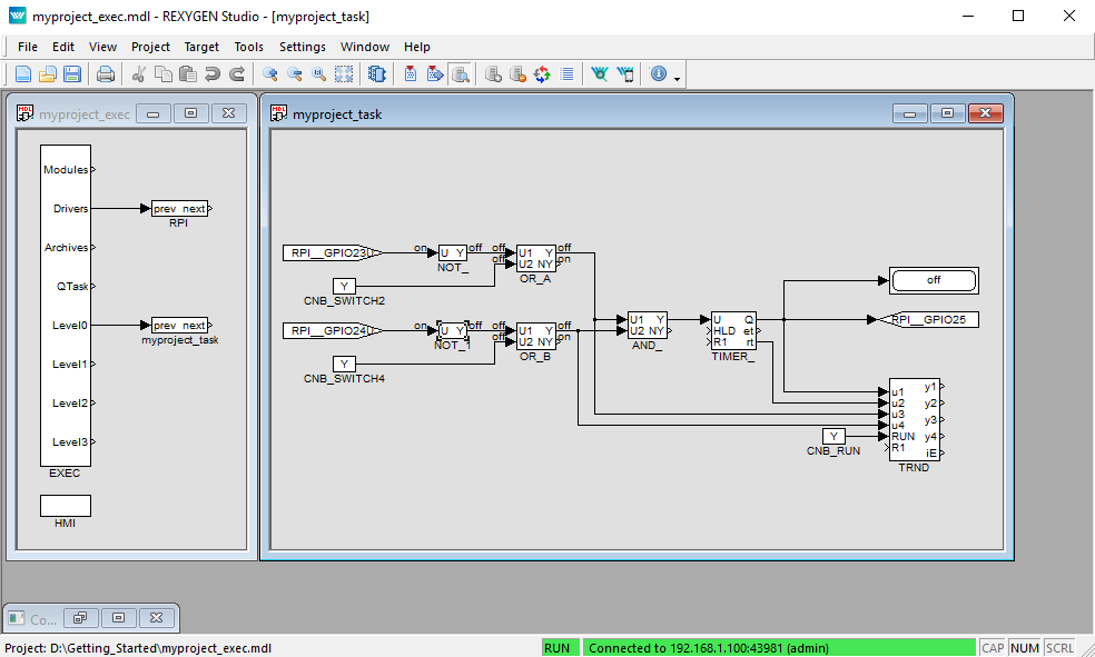

In the task double-click the input flag and set . Note the RPI prefix and two underscore characters. The first physical switch will be connected to GPIO#23 and an internal pull-up resistor will be activated.
The second physical switch will be connected to GPIO#24 (RPI__GPIO24U).
Note that the logic of the inputs is reversed by adding the NOT function blocks. Simply drag them from the library and drop them on the existing line.
The timer output will be routed to GPIO#25 and it will serve as the output signal (RPI__GPIO25).
Similarly for other pins we could use the following flags:
- Goto, RPI__GPIO22 – digital output 22
- From, RPI__GPIO7U – digital input 7 with internal pull-up resistor
- From, RPI__GPIO8D – digital input 8 with internal pull-down resistor
- From, RPI__GPIO21 – digital input 21 without pull up/down resistor

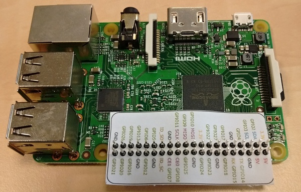

The pin numbering on Raspberry Pi B+, 2 and 3 is shown in the following pictures:
Visit the http://elinux.org/RPi_Low-level_peripherals webpage for detailed information about individual GPIO pins.
After compiling the project and downloading it to the Raspberry Pi the control algorithm interacts with the physical world. Again it is possible to switch to Watch mode and observe the signals in real-time or analyze the trends of signals. Flip the physical switches and watch the signals.
