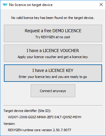

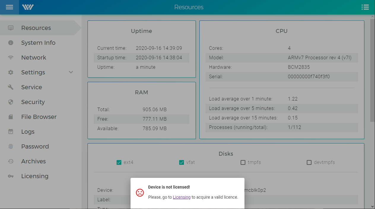

The first thing you will need is to get the license. The fastest way is to use the REXYGEN DWM tool. Open your web-browser and input IP address of Monarco HAT. You should see the Device is not licensed! message on the bottom of the screen. Please, click on the Licensing.
- The RexCore runtime module always needs a licence to run on your Monarco HAT. There are DEMO licences available at no cost and there are permanent licences which you can purchase. Each Monarco HAT needs an individual licence.

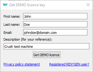

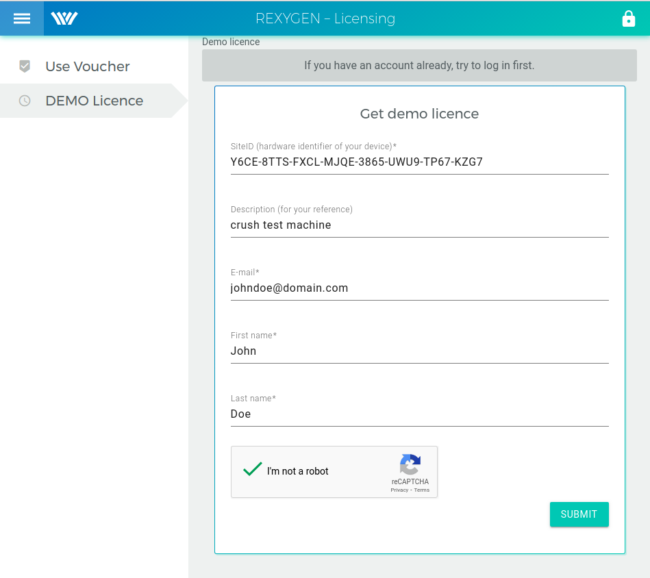

4.1 Obtaining a DEMO licence

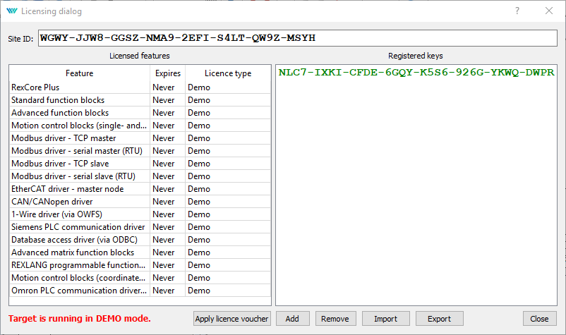

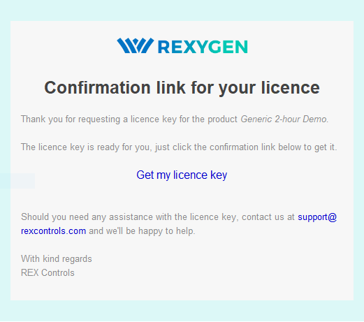

Click on Get demo licence and you will be redirected to the registration form. Identify yourself and you’ll receive a DEMO licence key via e-mail. The licence key is called a SiteKey.

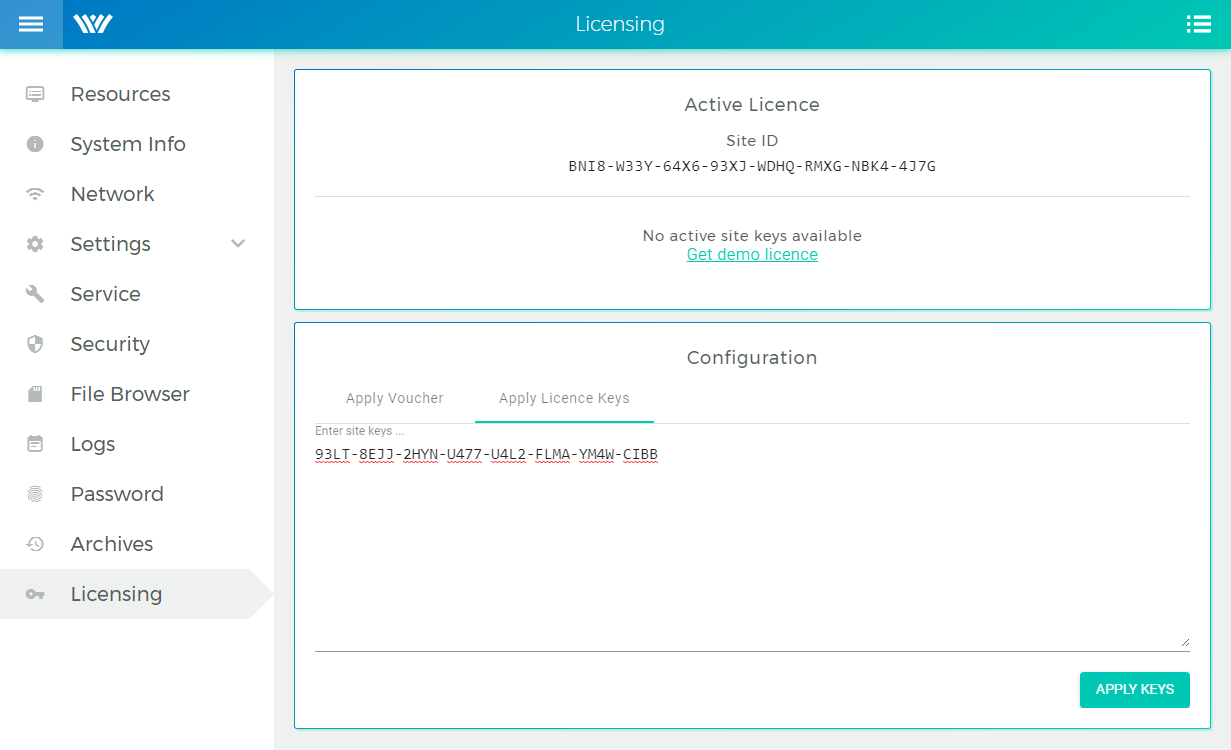

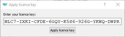

Once you have your DEMO licence key (SiteKey), apply it in REXYGEN DWMby selecting Apply Licence Keys and clicking on Apply keys.
Evaluation version of RexCore (REXYGEN runtime core) is functional for 2 hours. It is possible to run your algorithm on the Monarco HAT but you cannot store it permanently. The algorithm resides only in the RAM memory therefore it will not run after a restart or power-up. You can use almost all function blocks, see [1]. The RexCore runtime core on the target device is terminated after 2 hours of operation in demo mode without any warning. After a restart, you have another 2 hours for your experiments.

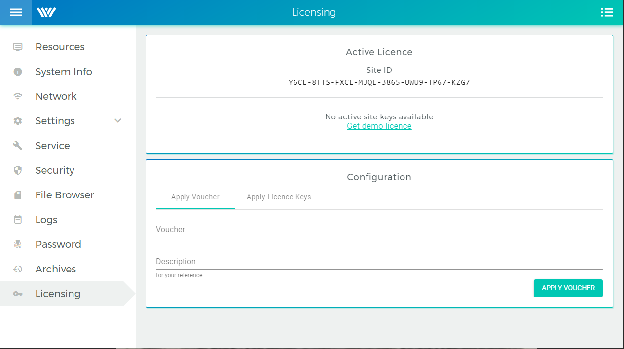

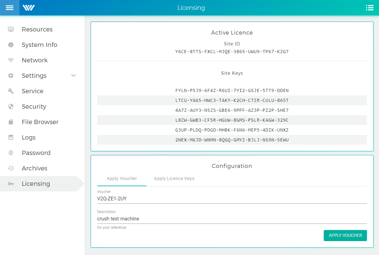

4.2.1 Activation of the permanent licence

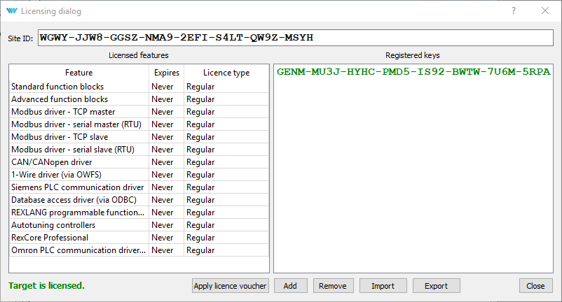

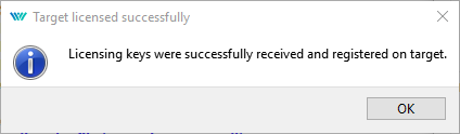

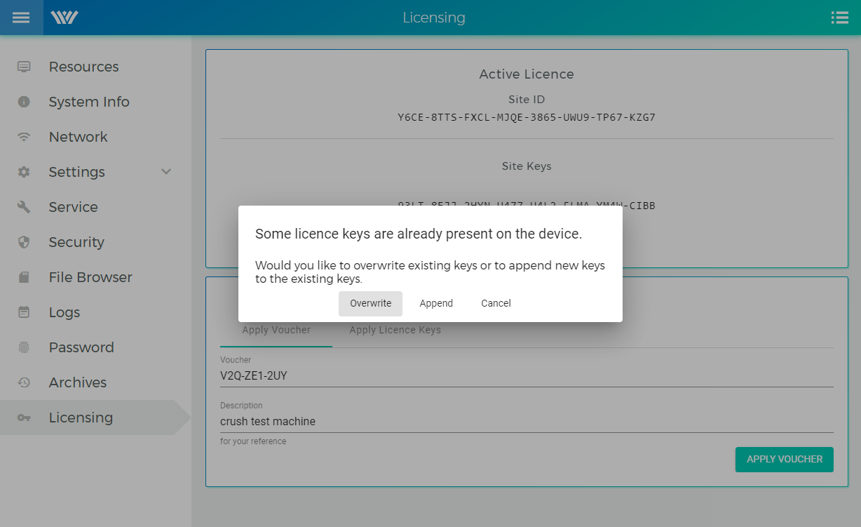

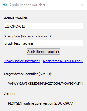

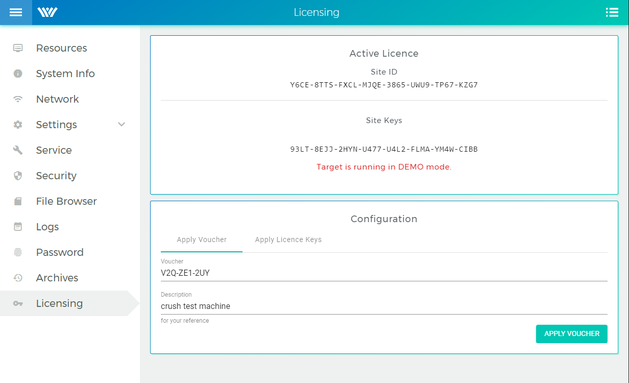

Each device running the RexCore runtime module is identified by the so-called SiteID tag. The purchased licence is associated with the hardware device, i.e. with the SiteID tag.
- Open your favorite web-browser on the desktop PC and fill in the IP address of
Monarco HAT. Once the DWM appears, select Licensing

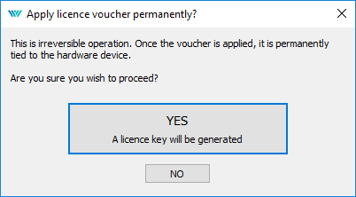

Apply Voucher and enter your licence voucher code.
- If other licenses are already present, a new window will appear where you can
specify what should happen to the old licenses. Use the Overwrite option if the
Monarco HAT is running in DEMO mode. This is the last and irreversible
in your device, which is shown in the Active License panel. The licence key allows
permanent operation of the runtime core. It is highly recommended to check the licence
again after a reboot of the device.

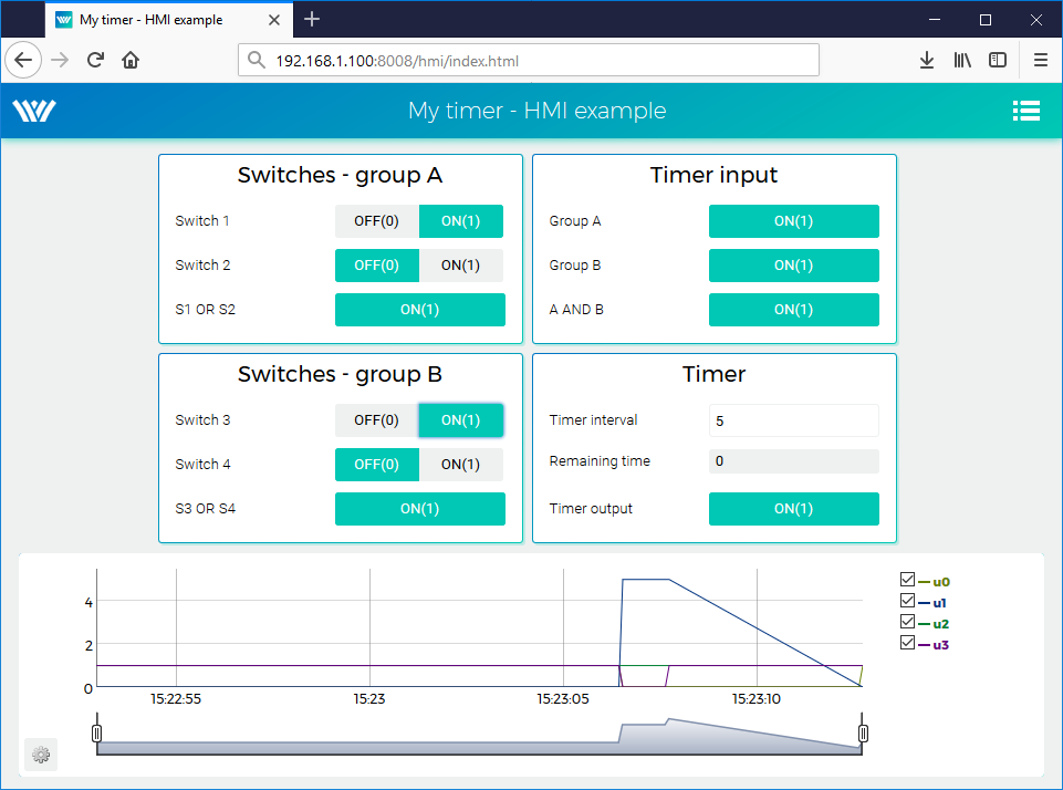

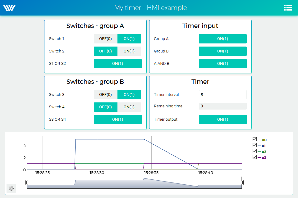

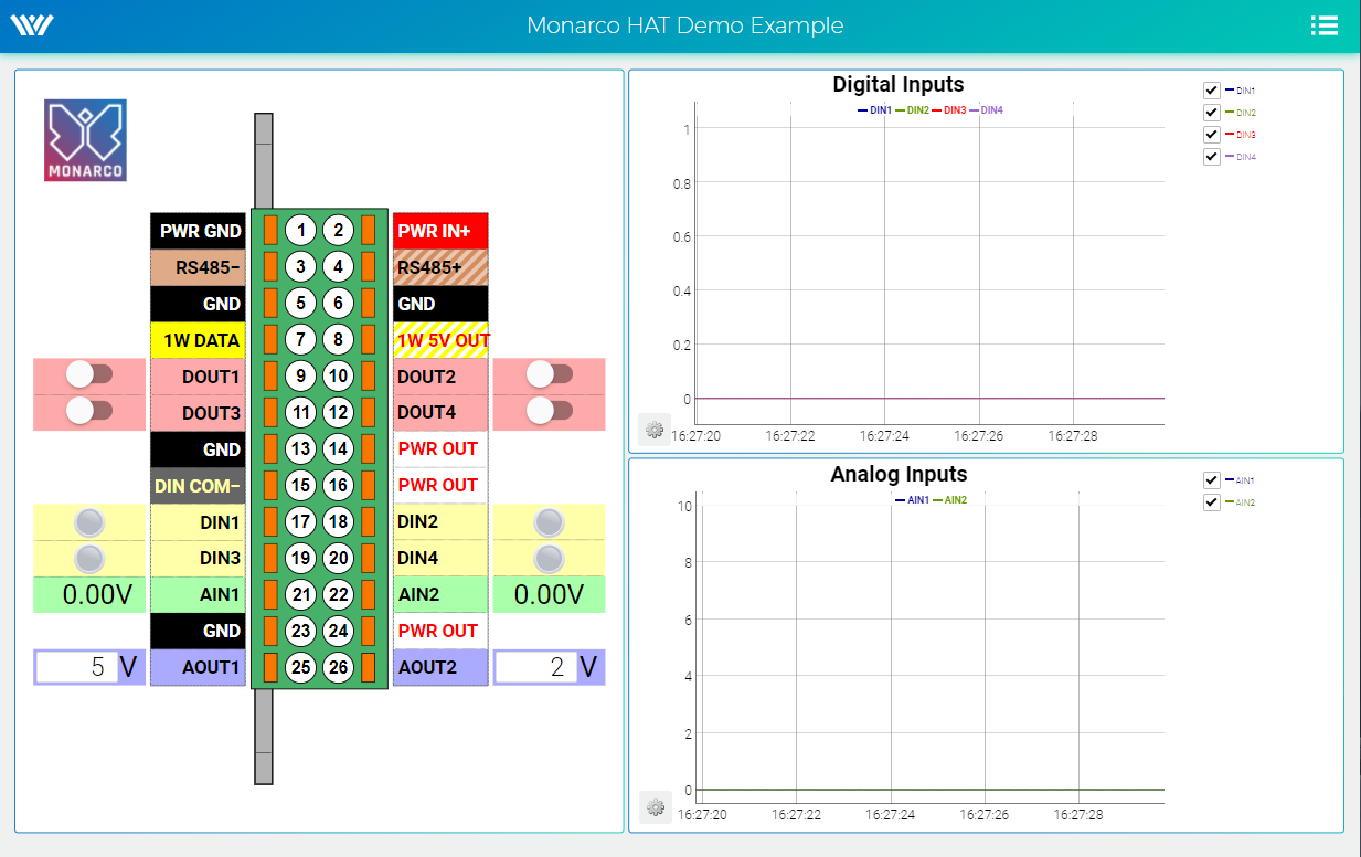

5.1 Control Monarco HAT from HMI
The project contains graphical user interface (so-called Human-Machine-Interface) for easy control and observing of general outputs and inputs. The HMI can be found at URL address http://192.168.1.100:8008/hmi/index.html (replace 192.168.1.100 with the IP address of your Monarco HAT).

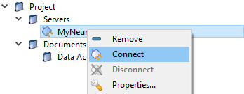

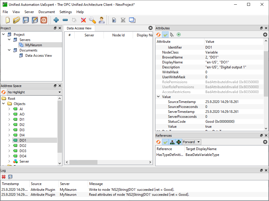

You can use the OPC UA interface to control your Monarco HAT too. Install any OPC UA
Client and connect to the OPC UA Server, which is running right now on your Monarco HAT.
There is the UAExport software used in this tutorial:
https://www.unified-automation.com/downloads/opc-ua-clients.html.

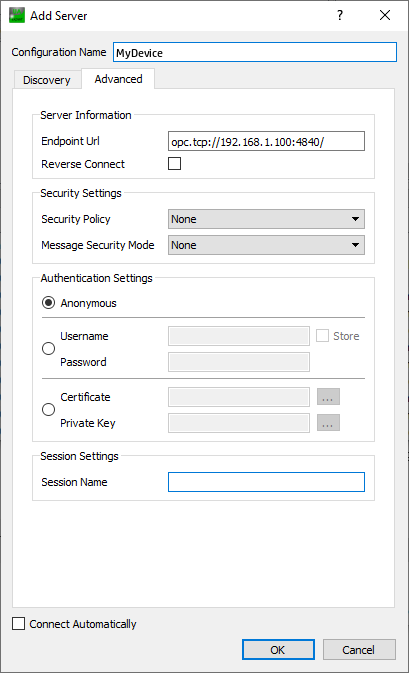

Click on Server in the Menu
Add
Advanced mode and fill the Configuration Name and the Endpoint URL (replace 192.168.1.100
After confirmation (OK), right-click on the new server name in the Project panel and choose Connect.
Congratulations, you are now connected to your Monarco HAT! You can now set the DO1 to value true for example. Navigate to Address Space panel and select DO1. In Attributes panel search Value Value, double-click on it, check the radio box and hit Enter. The first Digital outputs LED diod on Monarco HAT should glow. Detailed tutorial on using OPC UA with REXYGEN is there [3].

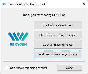

5.3 Loading project from Monarco HAT to REXYGEN Studio
After installation of REXYGEN development tools (described in Chapter 2), you can open the REXYGEN Studio on your PC and download algorithm of this default project from your Monarco HAT.

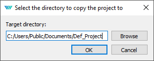

Select Load Project from Target Device from starting dialog or from File Open Project from Target Device and connect to your Monarco HAT (replace 192.168.1.100 with the IP address of your Monarco HAT).
Choose the directory where will be the project stored on your PC and hit OK.
If everything went well, the project algorithm will appear.

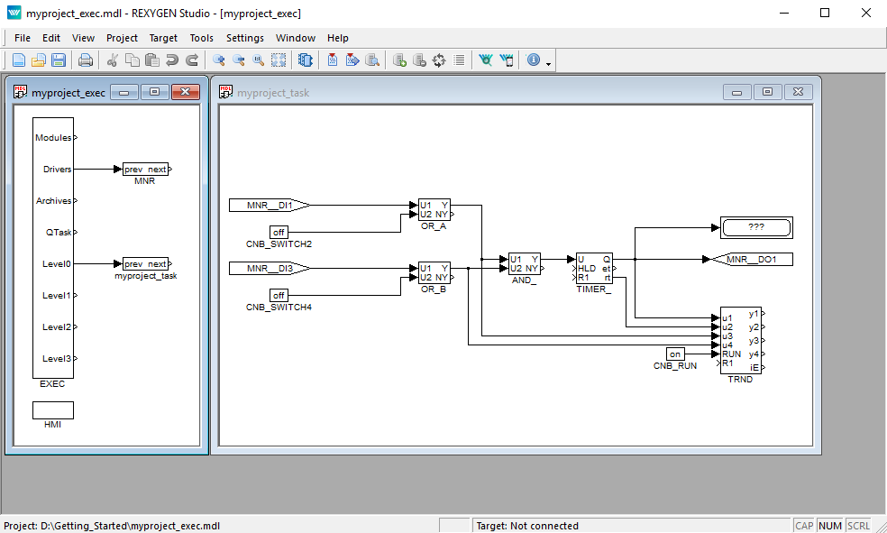

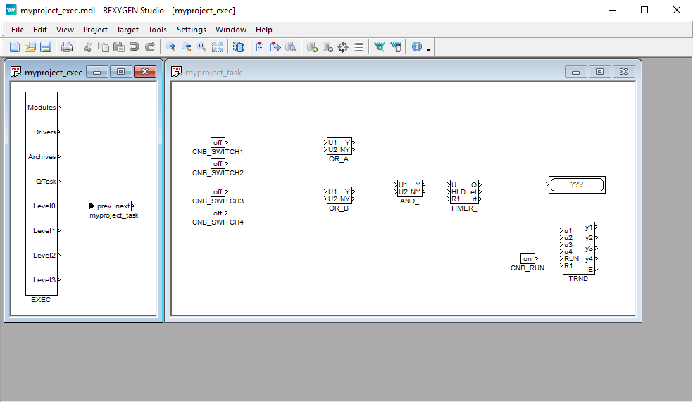

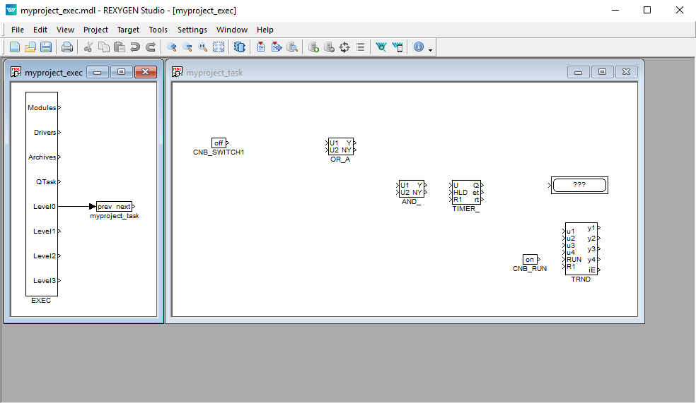

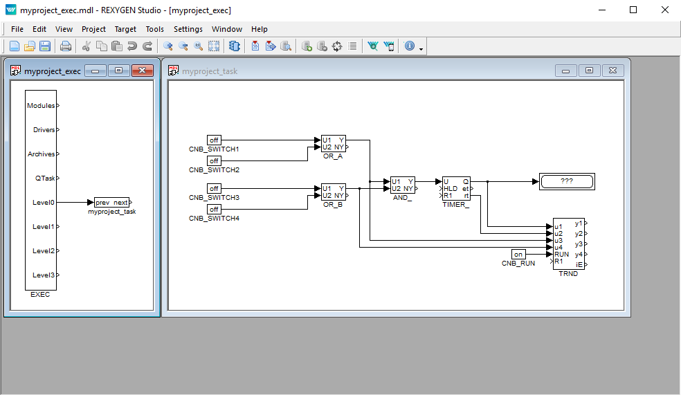

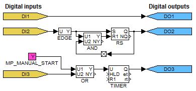

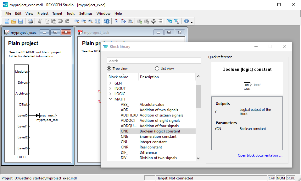

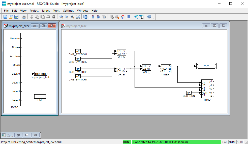

The process of creating a control algorithm will be demonstrated on a very simple example with four Boolean variables representing manual switches. In Chapter 7, two of them will be replaced by physical inputs of the Monarco HAT. A software timer will be used for measuring the time when the variables are true (i.e. the switches are in the ON position). A Boolean signal will indicate that the interval of predefined length has elapsed.

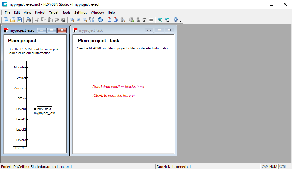

6.1 Creating a new project

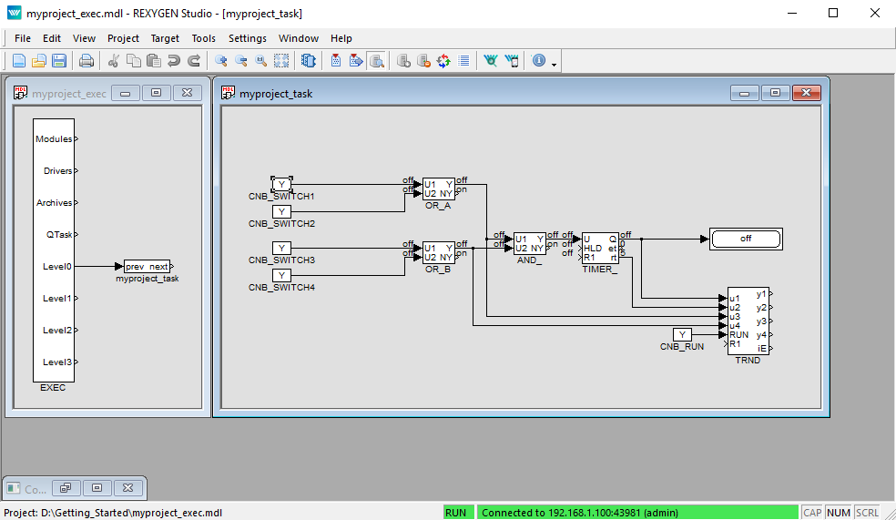

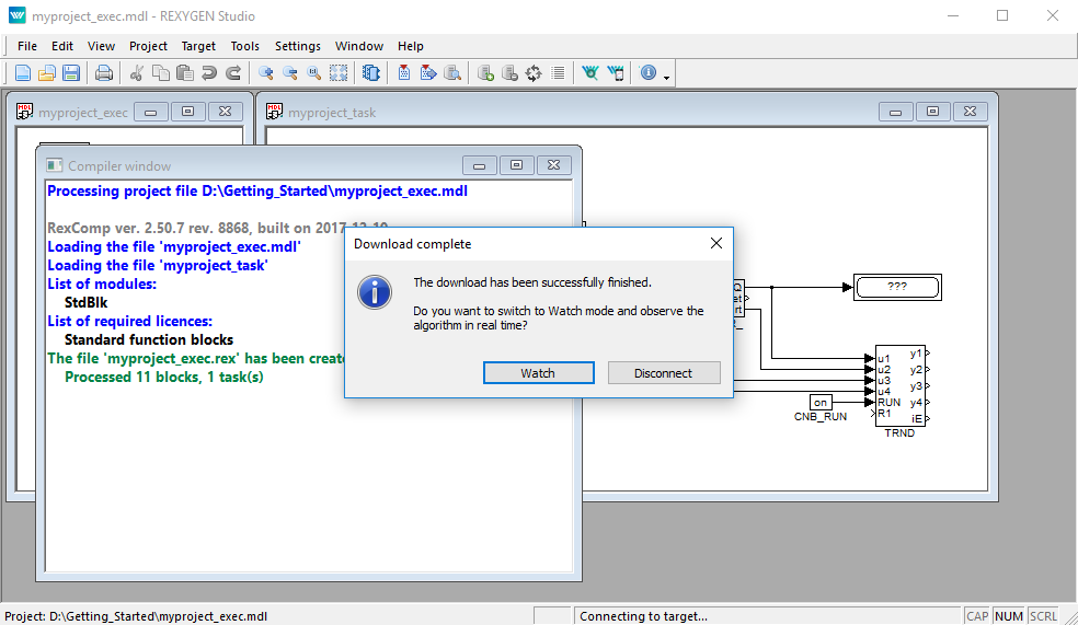

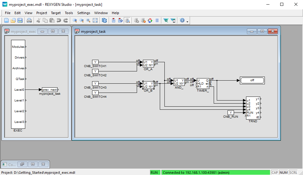

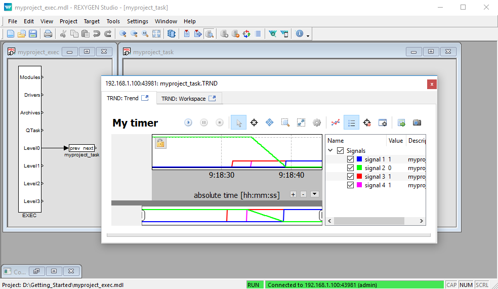

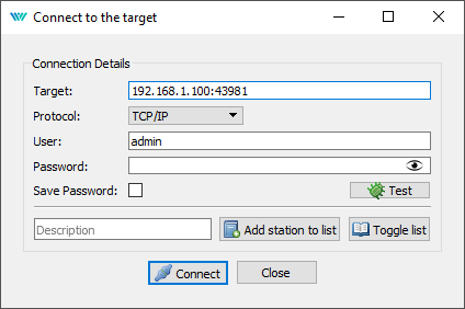

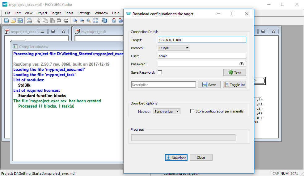

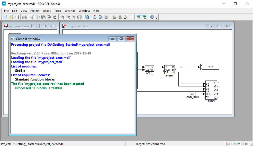

6.2 Compiling and running a project

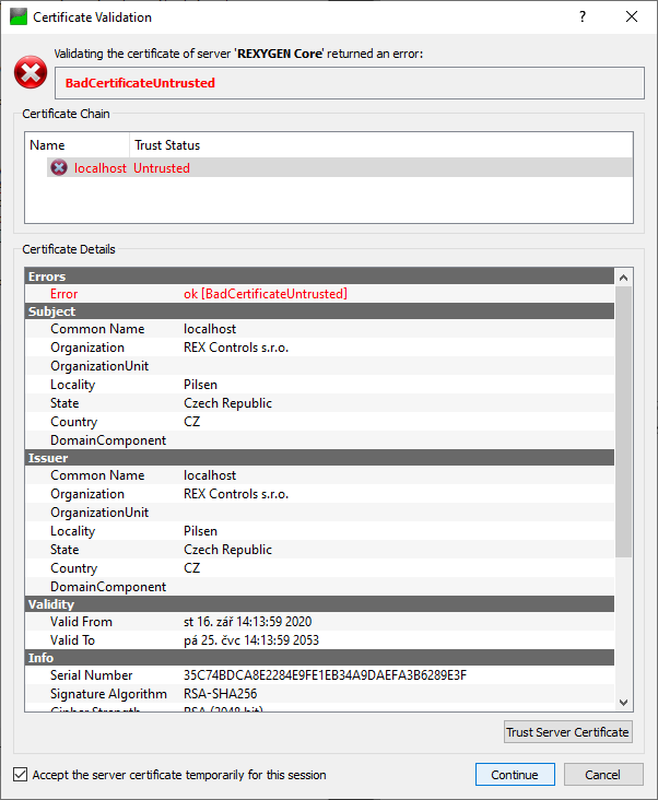

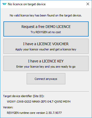

Enter the IP address of your Raspberry Pi in the Target field.
If there is no licence on your Raspberry Pi, you need to get one first. You can get a DEMO licence for free. See Appendix C for details and come back afterwards.
All changes made while in the Watch mode are not permanently stored in the target device (unless you decide so, see [4]). Upon restarting the RexCore runtime module the algorithm will start with the parameters defined in the project source files, which were valid when compiling and downloading the algorithm to the target device. To apply the changes permanently, you have to transfer the changes to the source files and Compile and download the project one more time which defines new startup values.

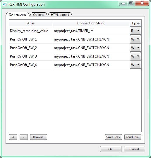

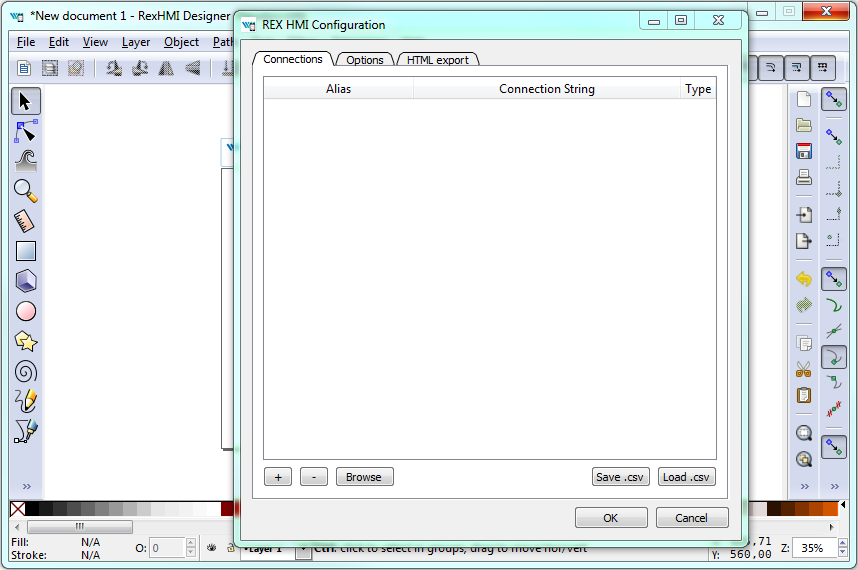

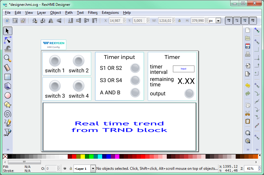

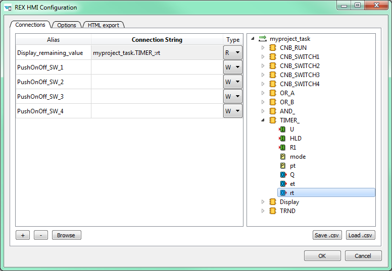

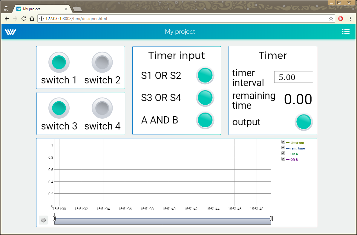

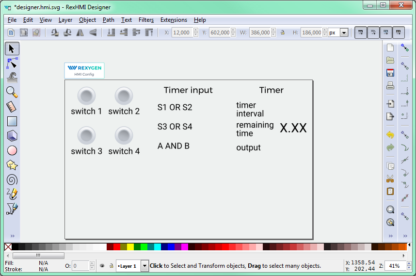

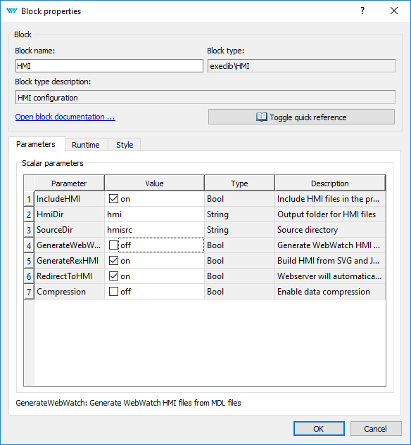

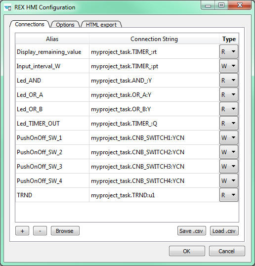

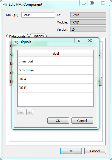

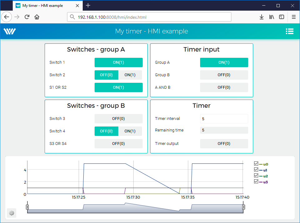

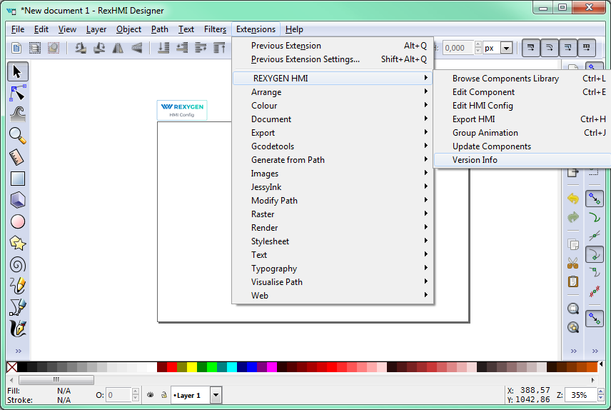

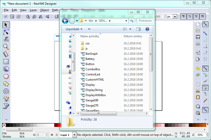

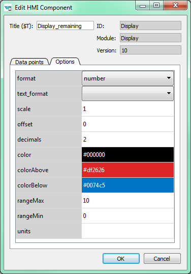

6.3 Adding a user interface (HMI)

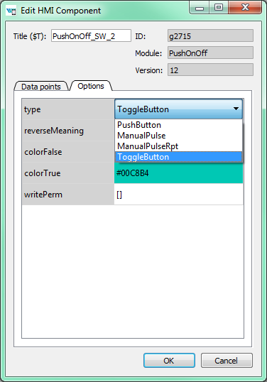

moment. See [5] for details, it is a very interesting tool for developers and
- See [5] for detailed information about WebBuDi elements and possible customization (colors, backgrounds etc.).
- The default URL address is http://192.168.1.100:8008/hmi/index.html (replace 192.168.1.100 with the IP address of your Monarco HAT).
6.4 Ready for interaction with the outer world

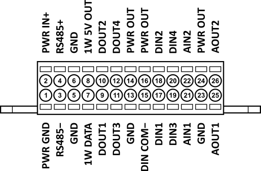

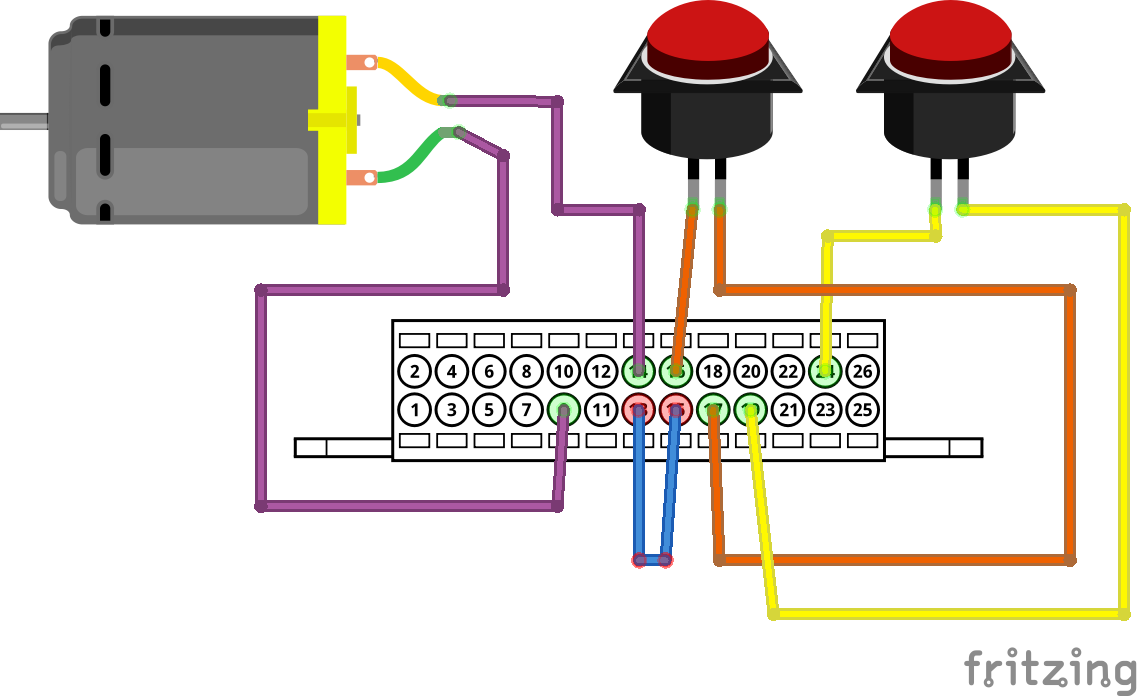

7.1 Physical connections
Connect the switches as shown below. The motor is optional, the onboard LED will indicate the status of the output.

7.3 Working with I/O signals
7.3.1 Modifications in the project main file

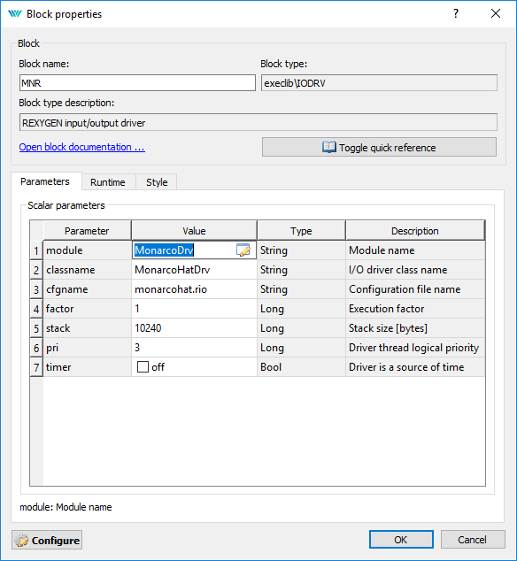

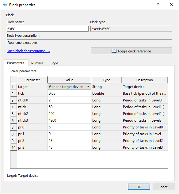

Now we tell the compiler to use the Monarco HAT I/O driver. To do this, edit the IODRV block parameters. Link the IODRV block with the MonarcoDrv module by setting
- – CASE SENSITIVE!

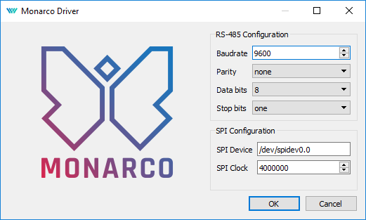

Continue editing the IODRV block parameters. For Monarco HAT set the following:
- – CASE SENSITIVE!
Remember to click the Configure button. This will create a default I/O driver configuration file (.rio). Keep the default values and close the dialog.
As the final step, rename the IODRV block to MNR, which will serve as a prefix for all I/O signals of this driver.
7.3.2 Modifications in the task

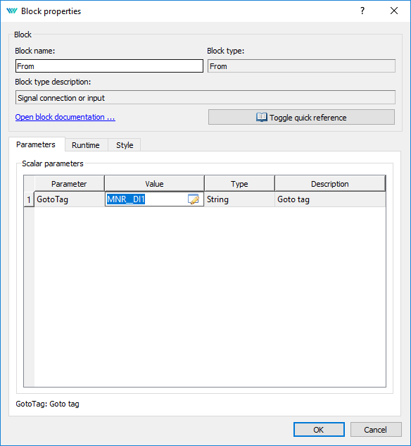

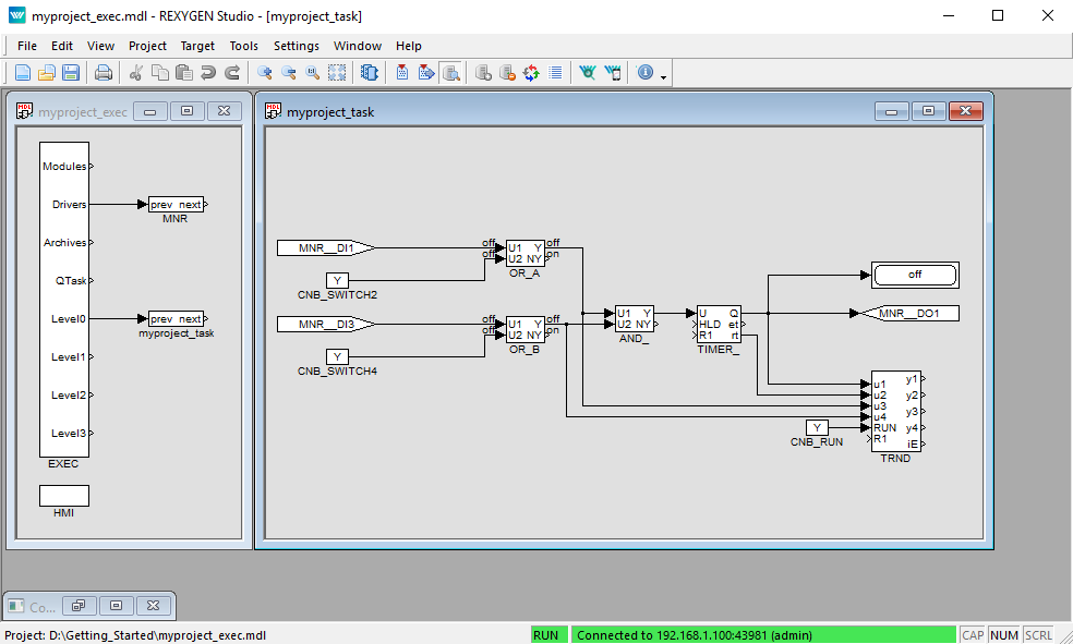

In the task double-click the input flag and set .Note the MNR prefix and two underscore characters. The first physical switch will be connected to DI1.
The second physical switch will be connected to DI2 (MNR__DI2).
The timer output will be routed to DO1 which will serve as the output signal (MNR__DO1).

A detailed description of the I/O driver for Monarco HAT is available in a separate manual [6].
The pinout of the Monarco HAT is shown in the following picture:

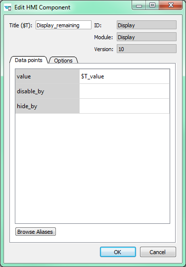

7.4 Updating the HMI

Chapter 6 describes the creation of a simple WebBuDi user interface. The REXYGEN development tools also contain the REXYGEN HMI Designer program which is a tool for designing custom graphical visualizations from predefined components (Definition of custom components is also possible but it requires a bit of Javascript coding.). The REXYGEN HMI Designer is based on the well-known open-source vector editor InkscapeTM https://inkscape.org/en/.
You can find the description of each component and property in [5]. Leave the default values
The Browser requires a target device with running algorithm. Make sure the algorithm is running, see Section 6.2. Also the target URL must be set. Press Browse button. The login dialog will be opened. Change Target to 192.168.1.100:8008 (replace 192.168.1.100 with the IP address of your Monarco HAT). Unless you changed the login credentials, use the default username admin with an empty password. After a successful login the connection tab is expanded with a tree-view of the running algorithm (you have already seen this tree-view in algorithm diagnostics).
As mentioned earlier, the *.hmi.svg files in the hmisrc folder are automatically processed while the project is compiled in the REXYGEN Studio application. The project main file must contain the HMI block with GenerateRexHMI parameter enabled. This was already covered in Section 6.3 so you should have everything ready.
Once you compile the project again and download it to your Raspberry Pi, the HMI will be
accessible via a web browser. Navigate to
of your Monarco HAT). You will see your HMI with live data.
This tutorial covers only the very basic components. If you want to get more information about additional components, see [5].

Appendix C
- The RexCore runtime module always needs a licence to run on your Raspberry Pi. There are DEMO licences available at no cost and there are permanent licences which you can purchase. Each Raspberry Pi needs an individual licence.
C.1 Obtaining a DEMO licence
Once successfully applied, your algorithm will download to your Monarco HAT.
C.2 Obtaining a permanent licence
C.2.1 Activation of the permanent licence
