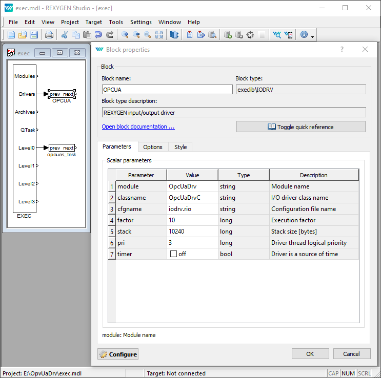

The project main file with the OpcUaDrv driver included is shown in Figure 2.1.
To include the driver in the project a block of type IODRV must connected to the Drivers output of the main EXEC block. The name of this block (OPCUA, see Fig. 2.1) must be used as a prefix of all blocks and input and output signals provided by this driver.
The most important parameters of IODRV block are:
- module – name of the module linked to the driver, in this case OpcUaDrv
- classname – class of the driver, which defines the role of the target device:
- OpcUaDrvC – for OPC UA Client
- OpcUaDrvS – for OPC UA Server
- cfgname – name of the driver configuration file, e.g. opcua_cfg.rio
- factor – multiple of the EXEC block’s tick parameter defining the execution period of the driver
The above mentioned parameters of the IODRV function block are configured in REXYGEN Studioprogram. The configuration dialog is shown also in Fig. 2.1.
The Configure button opens the configuration dialog of the OpcUaDrv driver, which is described in chapter 2.2.

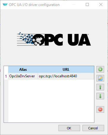

2.3 OPC UA Client

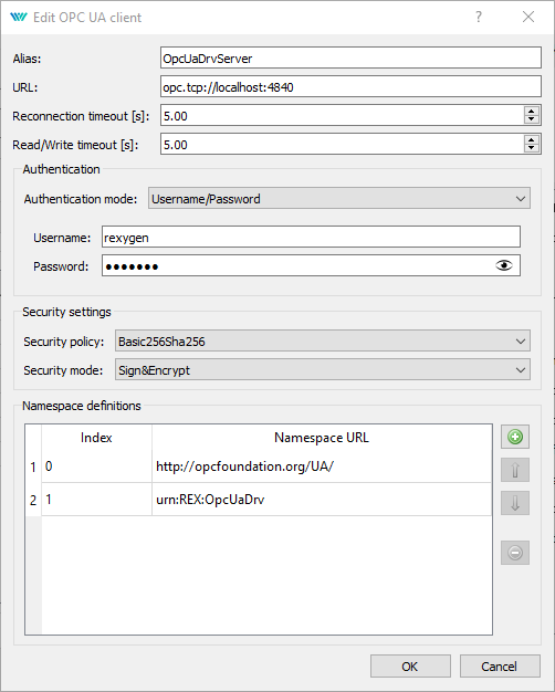

Single instance of the driver can process multiple client connections. The configuration dialog for OPC UA Client driver is shown in Figure 2.2 and has a form of a table of the client connections with buttons for adding, editing and deleting a connection. The configuration dialog for the client connection is shown in Figure 2.3.
Client connection parameters:
- Alias
- – mandatory, Alias must be specified in the name of the flags and blocks that belong to the context of this connection.
- URL
- – address of the server
- Reconnection timeout
- – number of seconds to wait between connection attempts
- Read/Write timeout
- – number of seconds to wait for Read/Write operations to finish
- Authentication
- – section for authentication configuration
- Security
- – section for security configuration
- Namespace definitions
- – section for definition of the namespaces as they are defined
on the server
– Indexes of the namespaces are used to compose the NodeId parameter of the OPC UA blocks.
– During the initialization of the connection the namespaces defined in the table get resolved and the indexes on the client side get translated to the real indexes on the server side.

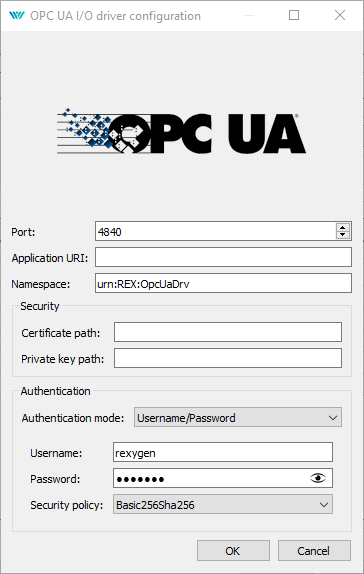

2.4 OPC UA Server
The configuration dialog for OPC UA Server driver is shown in Figure 2.4.
Server parameters:
- Port
- – port of the server
- Application URI
- – identifier of the application
– Application URI must be the same as the URI defined in the certificate used by the server.
– If a custom certificate is configured Application URI must be set to match. Leave empty otherwise. - Namespace
- – namespace to be used for all nodes
- Certificate path
- – path on the target device to a custom certificate to be used
- Private key path
- – path on the target device to a custom private key to be used
- Authentication mode
- – configuration of the authentication
– Anonymous – no authentication
– Username/Password – authentication by a username and password - Username
- – username
- Password
- – password
- Security policy
- – policy to be used as user token policy during authentication

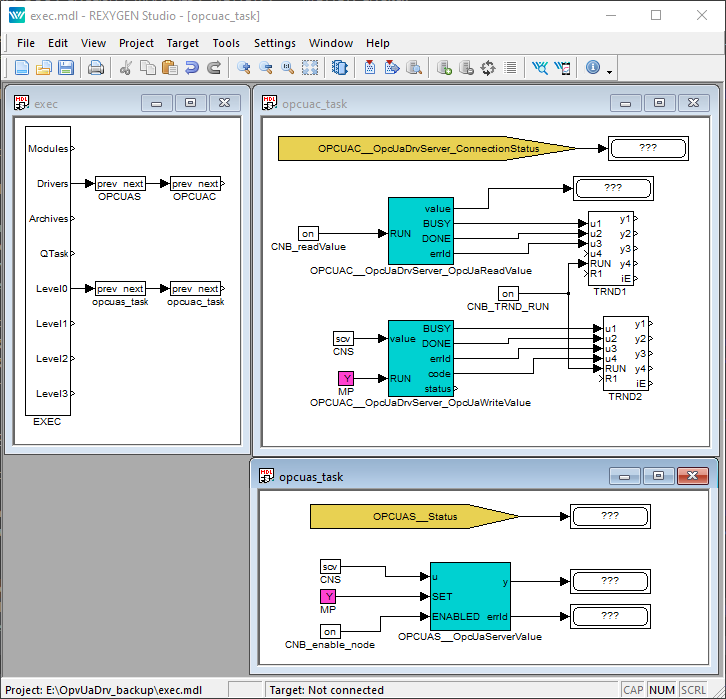

3.1 Direct input and output signals
The inputs and outputs of the OpcUaDrv driver can be accessed as shown in Fig. 3.1.
First block of the From type allowing the user to read connection status has the Goto tag set to OPCUAC__OpcUaServer_ConnectionStatus. Another block of the From type allowing the user to read status of the server has Goto tag set to OPCUAS__Status. The blocks always have the name of the driver block as a prefix right at the beginning of the tag followed by two _ characters (underscore). If the block belongs to the client driver the name of the driver with underscores must be followed by the alias of the client connection defined in the driver configuration dialog and another underscore.
3.2 Function blocks
3.2.1 OPC UA Client
The OPC UA Client driver is responsible only for maintaining the connection to the server. To read a value of an OPC UA Node over the OPC UA protocol the OpcUaReadValue block must be used. To write value an OPC UA Node the OpcUaWriteValue block must be used. The function blocks of the OpcUaDrv driver can be used as shown in Fig. 3.1. The blocks always have the name of the driver block prefix right at the beginning of the tag followed by two _ characters (underscore) and that is followed by an Alias identifying the client connection. To learn more about the OpcUaReadValue and OpcUaWriteValue blocks see [4].
3.2.2 OPC UA Server
The OPC UA Server driver is responsible for handling all the communication from the clients. To create and expose an OPC UA Node the OpcUaServerValue block must be used. The function blocks of the OpcUaDrv driver can be used as shown in Fig. 3.1. The blocks always have the name of the driver block as a prefix right at the beginning of the tag followed by two _ characters (underscore). To learn more about the OpcUaServerValue block see [4].
