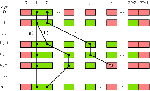

The following figure demonstrates the state space search in depth. Green rectangles corresponds to feasible state, red rectangles to infeasible states. Variants a) and b) represents feasible paths, path in variant c) is not feasible.
The number of all states of this algorithm in the state space grows exponentially. Ideally, the number of all feasible states is equal to
| (15.4) |
Therefore, this algorithm is computable only for a low number of generators , (e.g. ) and a short start horizon (e.g. ). For a larger number of generators and/or a longer horizon , it is necessary to reduce the number of states in the state space. One option is to limit the maximum number of generator state changes (i.e. start a stopped generator or stop a started generator) at each step.
