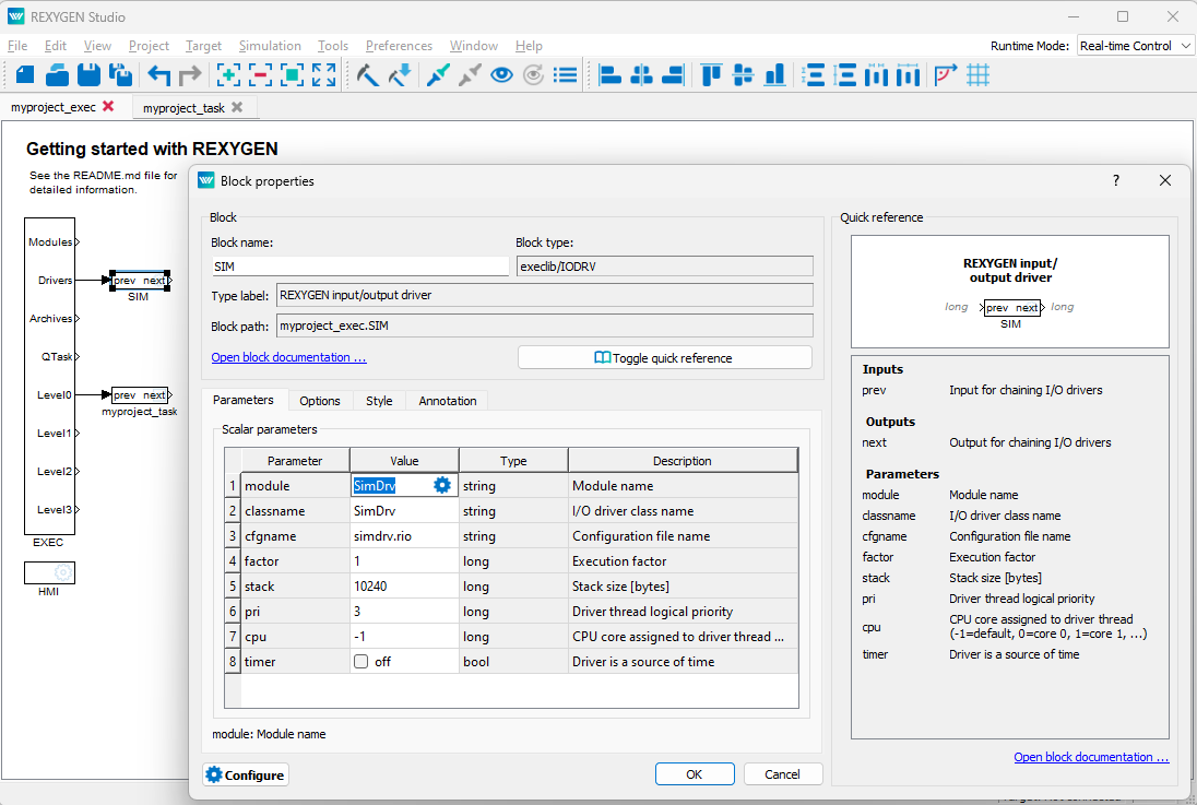

The addition of the SimDrv driver to the main project file is illustrated in Fig. 2.1. The philosophy of using SimDrv is such that the driver should replace another, specific driver.
To integrate the driver into the project, the IODRV block is used, which is connected to the Drivers output of the main EXEC block. The SimDrv driver is a special type of driver as it serves to temporarily replace a real driver. The standard convention for naming drivers tells us that the driver should be named after its type. In this specific case, we should thus name the driver SIM (see Figure 2.1). However, the name of the driver also determines the names of all its input and output signals. If we were to name the SimDrv driver SIM, we would have to modify the names of all its input and output signals when exchanging the driver. Therefore, it is advisable to name the SimDrv driver to match the name of the replaced driver, for example, MNR, RPi, WG, etc. The four most important parameters of the IODRV block are:
- module – the name of the module in which the driver is implemented, in this case, SimDrv
- classname – the driver class, in this case, SimDrv
- cfgname – the name of the driver configuration file. The creation of the configuration file is described in chapter 3. It is recommended to enter it in the form <class_name>.rio, where the extension *.rio (REXYGEN Input/Output) has been introduced for this purpose.
- factor – a multiple of the tick parameter of the EXEC block defining the period for executing driver tasks.
ATTENTION! The parameter settings are case sensitive!
The parameters of the IODRV block just described are configured in the program REXYGEN Studio in the dialog box, which is also shown in Figure 2.1.
The Configure button opens the configuration dialog for the SimDrv driver, which is described in chapter 3.

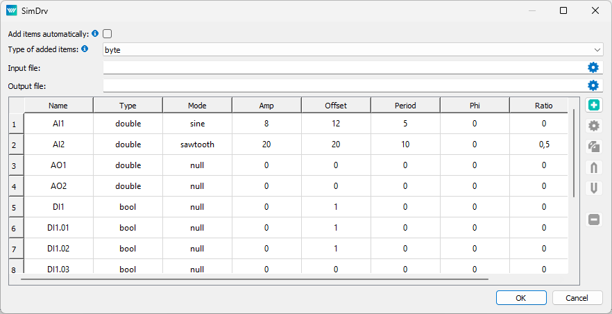

The configuration dialog window depicted in Fig. 3.1 is part of the SimDrv_H.dll file. It can be activated via the REXYGEN Studio program by clicking on the Configure button in the IODRV block parameter dialog window (see Chapter 2) or by clicking on the gear icon located on the right side of the IODRV block.
At the top of the dialog are several objects of global significance:
- Add items automatically – If checked, when compiling with REXYGEN Compiler, all references to I/O blocks from all connected tasks that are not yet in the configuration will be automatically added. If unchecked, items will be used only for compilation by REXYGEN Compiler to avoid compile errors, but will not be added to the configuration file.
- Type of added items – The type of items that will be automatically added. If Unknown is selected, the item will not be added and an error will be reported during compilation.
- Input file – CSV file with values for inputs. Can be used instead of Mode at the bottom of the configuration window.
- Output file – CSV file where output values will be saved.
In the bottom part of the window, individual signals are defined which can then be used to simulate reading or writing in the REXYGEN control system. Simply add signals, or have them automatically generated at compilation by checking the Add Items automatically option.
Signals can be added to the table by pressing the Add item button, edited with the Edit item button, or by double-clicking on an item in the table. See Fig. 3.1.
3.1.1 Displaying Configured Signals
In the middle part of the dialog window, the configured signals are displayed in a tabular format. Each row corresponds to a signal with an assigned symbolic name. The columns of the table have the same meaning as the input fields during configuration and are described in Section 3.1.2.
3.1.2 Configuration of Inputs and Outputs
The other elements of the dialog (i.e., the input fields at the bottom) from Fig. 3.1 are used for the configuration of input and output signals. These are the fields:
- Name – The name of the signal in the REXYGEN system. It must be entered uniquely.
- Type – The type of signal. The significance is evident. It is recommended to use the following types:
Bool boolean signal, Long integer (32 bits signed, i.e., -2147483648 …2147483647) Double floating-point number (64-bit range) - Mode – The mode for signal generation. For outputs (i.e., signals from the .mdl drawing to the driver), it must be Null. For inputs, there are several generators, with the generator’s value multiplied by the Amplitude parameter and the Offset parameter’s value added to the result, i.e., . For periodic generators, the start of generation is shifted by the value given by the Phase parameter. The following modes generate:
Null a constant value determined by the Offset parameter, Noise a pseudo-random number in the range , Rectangle a rectangular pattern – alternating values of 1 for and -1 for the remainder of the period, Sawtooth a triangular pattern – value with linear increase for and linear decrease for the rest of the period, Sin function , Filter 1st order filter from the signal, whose number is in the Period parameter, i.e., , - Amplitude – The amplitude of the generated signal.
- Offset – The offset of the generated signal (added to the value).
- Period – The period of the generator in seconds.
- Phase – The relative shift of the generator’s start in time; it can take values .
- Ratio – The proportion of the first part of the period for the types Sawtooth and Rectangle; it can take values .
