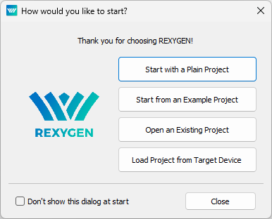

When you start REXYGEN Studio for the first time, you will be greeted by the dialog box (figure 1.1) where you have several options to start your work. If you choose the Start with the Plain Project option, you will be prompted to choose a folder where the project will be saved and a project will be created with minimal configuration that can be uploaded to your target device. The REXYGEN installation includes an extensive library of examples. We recommend starting the project by choosing an example, which you will then modify. The Start from the Example Project option is used for this. If you have an already prepared project available, you can open it using the Open an Existing Project option. The last option - Load Project from the Target Device will allow you to retrieve the currently saved project from the target device. Attention: The source files of the project must be stored on the device!

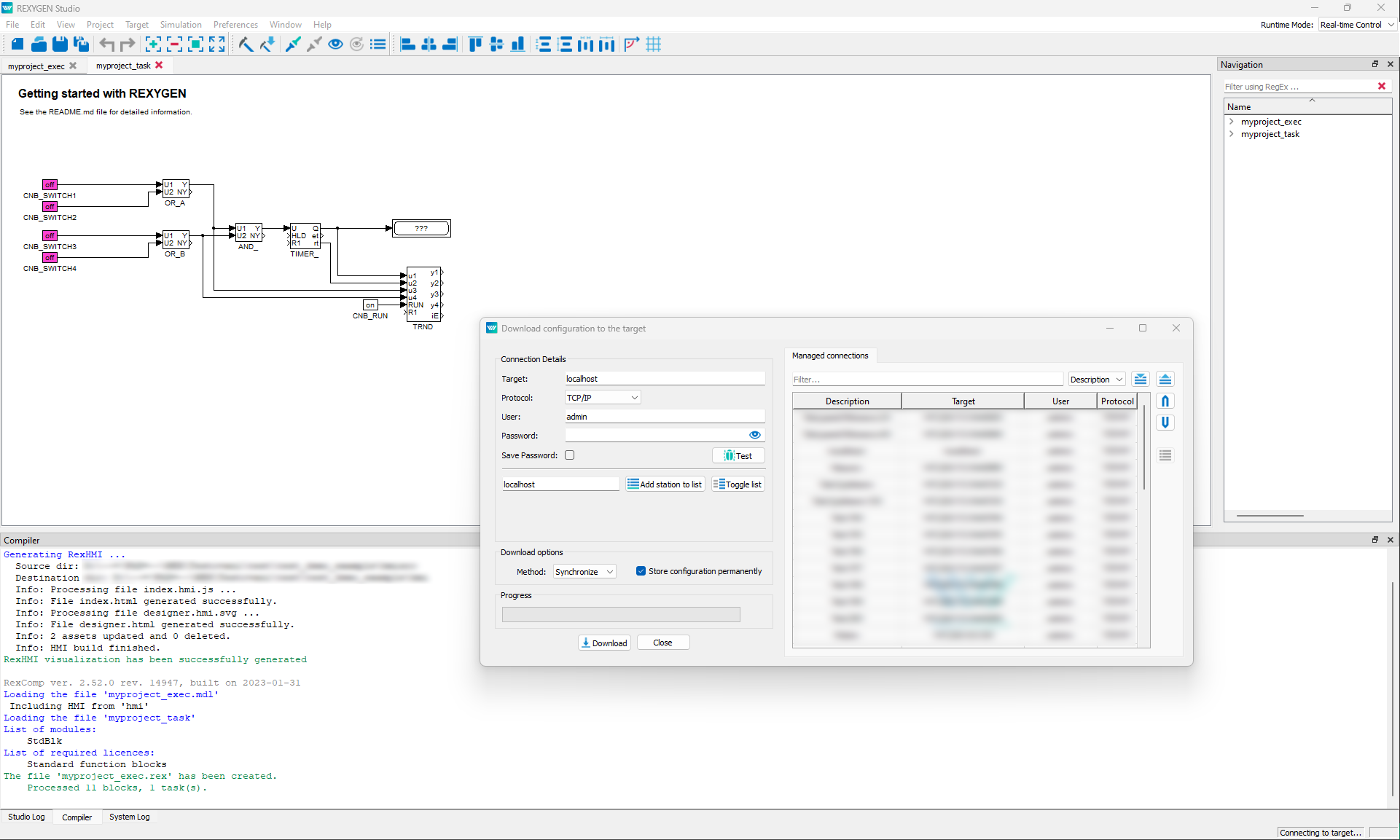

A configuration is downloaded into the target device by selecting Compiler/Compile and Download from the menu, clicking on the icon on the toolbar or using the F6 shortcut.
A compilation of a project into a binary configuration is always performed before it is downloaded into the target device to ensure consistency. If an error occurs during the compilation, a compiler window is shown and the download operation is not available. A user must fix all errors indicated by the compiler before proceeding with the download.
The download option Store configuration permanently is required to save the project configuration on the target device so that it gets loaded automatically when the target device boots up (e.g. after a restart, power cycle, power loss, etc.).

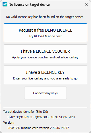

Before a binary configuration may be downloaded and activated the target has to be properly licensed. For a permanent target operation, a full target licence can be obtained from www.rexygen.com/pricing. A DEMO licence is available for experiments and development. A DEMO licence may be obtained directly from the REXYGEN Studio application while connecting to an unlicensed target. A user may also get the DEMO licence from the web page of the REXYGEN.
An information dialog about licensing is shown while connecting to an unlicensed target (figure 2.2). A user has the following three options:
Request a free DEMO LICENCE: Select this option if you want to obtain a DEMO licence directly by filling in the name and email address to which a licensing key is sent (figure 2.3).
I have a LICENCE VOUCHER: Select this option if you already have a valid licence voucher and you want to apply it to the target device.
I have a LICENCE KEY: Select this option if you already have a valid licence key and you want to apply it to the target device.
Connect anyways: Select this option if you want to continue without licensing the target. But be aware that most of its functionality is not available without an active licence.

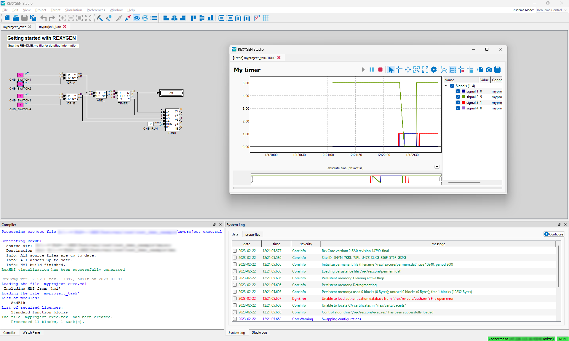

The blocks TRND and TRNDV are available in REXYGEN to monitor signals over a period of time. The TRND allows to store up to 4 signals and the TRNDV allows to store up to 64 signals in the RAM of the target device. The samples are stored synchronously during task execution. This allows us to store and observe very fast processes without losing a single sample.
The diagnostic tool of the REXYGEN Studio makes it possible to show all the data stored in the memory of the TRND block in the Watch mode. To show a window with all data signals shown in a graphical trend simply double-click on a TRND block while the REXYGEN Studio is in the Watch mode. A data may be zoomed, a scale and a range of both axes may be changed and the data may also be exported to a CSV file from the window.
2.4.3 Viewing REXYGEN System Log
A system log with errors, warnings and other info messages with timestamps are present on every target device. A user may display the content of the system log directly from the REXYGEN Studio selecting Target/Show System Log from the menu or by clicking on the icon on the toolbar. A user may browse all messages, filter the content or export selected/all items to a CSV file.
The types and severities of messages that are written to the REXYGEN System log may be configured by selecting Target/Configure System Log from the menu. The Safe print flags to the target option must be selected if it is required to store the configuration of the system log permanently on the target device. A last saved configuration is loaded during the next system boot if the option remains unselected.
2.4.4 Diagnostics
A detailed diagnostics tool may be launched by clicking on Target/Diagnostics from the menu or by clicking on the icon on the toolbar. The diagnostic tool window is closed automatically when REXYGEN Studio disconnects from the target device.

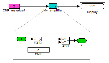

- Copy the SubSystem block from the INOUT library to the given diagram (.mdl file). Enter the subsystem with a double-click. Duplicate Inport and Outport blocks as needed. Insert function blocks as needed. Route the signals from Inports through function blocks to Outports. Rename Inports and Outports as needed.
- Select a group of blocks and use the Create subsystem command (in menu EditCreate subsystem). The selected blocks are then replaced by a subsystem block, which contains all the original blocks and Inport and Outport blocks for signals crossing the subsystem boundary.
The resulting subsystem contains function blocks and their connections as shown in Figure 3.1.

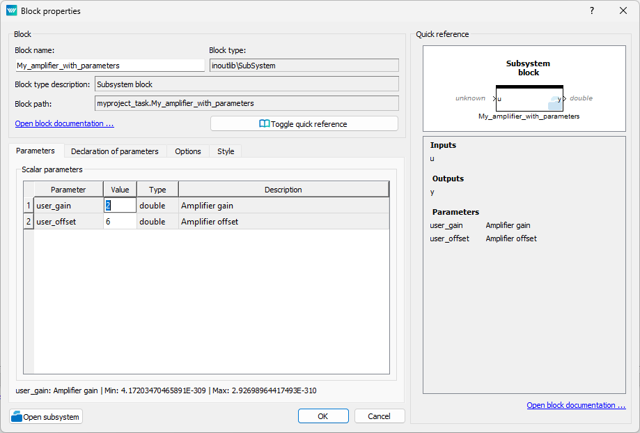

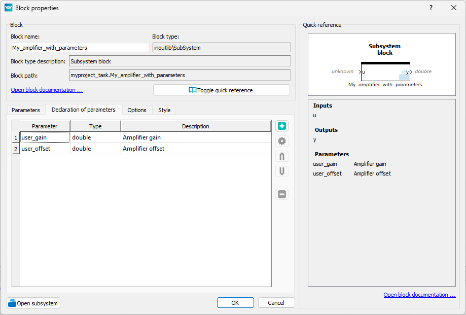

A typical requirement for a subsystem is to have parameters just like a standard function block to allow the parametrization of its functionality.
For this purpose, the so-called subsystem parameters can be defined. The values of parameters can be used inside the subsystem. Each parameter also has a description of its meaning. To declare subsystem parameters, select one subsystem block and go to menu EditDeclaration of Parameters. A dialog appears (see Figure 3.2) and you can declare parameters and the corresponding descriptions.
Once the parameters are declared, the subsystem acts just like any other block – double-click it to open the Block properties dialog. You can see the dialog contains the parameters which were declared (Figure 3.3).

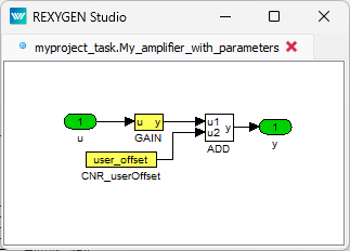

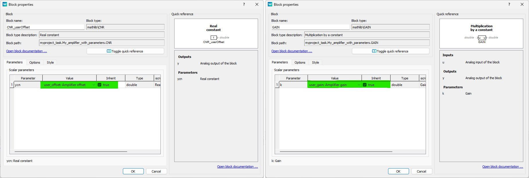

Now you need to edit the internals of a subsystem with parameters. Select it and go to menu EditOpen Subsystem.
The function blocks inside a subsystem must be configured to accept the values of the declared parameters. To do so, open the Block properties dialog of individual function blocks, tick the Inherit checkbox and select the corresponding parameter (Figure 3.4).
The internals of the finished subsystem with parameters is shown in Figure 3.5.

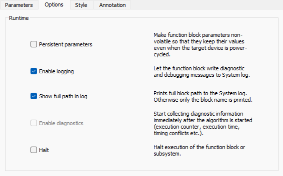

Functional blocks can be partially influenced in their behavior during runtime. For example, it is possible to stop the execution of a specific block. This setting can be adjusted in the Options tab of each block.
5.1 Persistent parameters
REXYGEN supports permanent storage of function block parameters. Internal states of selected function blocks can be made persistent as well. Persistent memory performance is target platform specific. If the target platform does not have any supported persistent memory available, the permanent parameters will be stored to the permem.dat file by default (to the same directory as exec.rex is stored - /rex/rexcore on Linux targets or C:\ProgramData\REXControls\REX_<version>\RexCore\ on Windows targets).
In order to store the function block parameters, the checkbox Persistent parameters in block properties must be checked. All function block parameters and also internal states in selected blocks will be stored (excluding arrays).
The list of function blocks with persistent internal states follows:
- INTE
- SINT
- COUNT
- SHIFTOCT
- OSD
- SHLD
- DIF_
- TIMER_
- ABSROT
- E/ATMT
The default save period is 300 seconds, default persistent memory size is 10240 bytes.
The persistent memory can be reset or cleaned up using Download Dialog - see Fig. 2.1. Switch the Download option in Download Dialog to Expert mode and choose between Reset persistent memory or Cleanup persistent memory. Reset persistent memory will replace the entire persistent memory however Cleanup persistent memory will erase just the parameters which are not used anymore.
Permanent storage file, its size, location and save period can be changed using configuration file rexcore.cfg. Find more details in the RexCore User Guide[2].
Be aware that the block parameters will be overwritten with the ones stored in persistent memory immediately after swapping executives if the Persistent parameters option is enabled for the function block.
5.2 Enable logging
Certain function blocks such as ATMT, PIDU, and others have the capability to write diagnostic and debugging messages to the System log. To enable this functionality, the Enable logging option must be activated. Moreover, you must select the appropriate logging level in System Log Configuration -> Function block messages. For the SYSLOG function block, this option has a special meaning. When it’s not active, SYSLOG only writes the message from the input msg. However, when it’s active, the message is prefixed with the SYSLOG name.
5.3 Show full path in log
Prints full block path to the System log. Otherwise only the block name is printed. This option only makes sense when Enable logging is checked.
5.4 Enable diagnostics
Start collecting diagnostic information immediately after the algorithm is started (execution counter, execution time, timing conflicts etc.). This option is intended for tasks, drivers and subsystems blocks.
5.5 Halt
Halt execution of the function block or subsystem.
