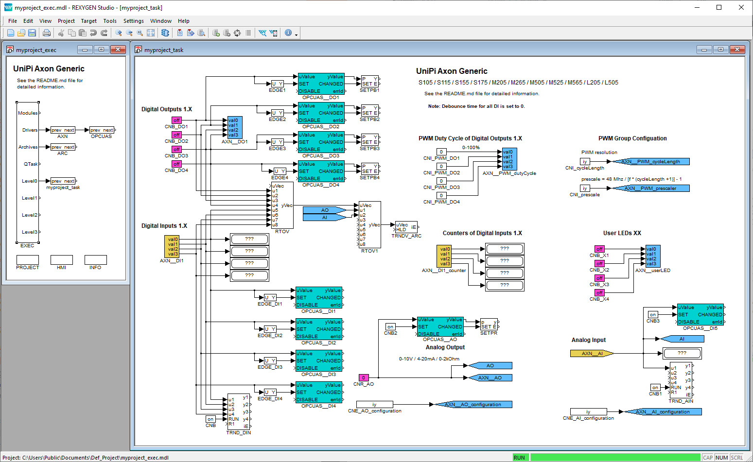

In order to help you speed up a start with REXYGEN and UniPi Patron we have create an example project for most UniPi Patron which is already preinstalled on the image with REXYGEN (installation is described in Section 3.1). The project serves as a basic validation of the installation process and as a starting point for more complex applications. One can control digital output(s) DO, analog output(s) AO, observe the state of digital inputs(s) DI and analog input(s) AI. These general inputs and outputs are present on all UniPi Patron models. The steps to create and develop a new project from scratch is described in Chapter 6 in detail.
IMPORTANT: If you have valid permanent licence stored on your UniPi Patron, this
project will start automatically once RexCore (REXYGEN runtime core) starts. Otherwise, if
you have only a Demo license, you must compile and download the project from
the REXYGEN Studio on the UniPi Patron first. The project can be opened in the
REXYGEN Studio using either the procedure described in Section 5.3, or the project
can also be found in the Examples library as 0127-02_UniPi_Patron_Generic (All
examples which are part of the installation are marked by an ExampleID. The most
up-to-date examples are available with the latest installation of development tools or at
https://www.rexygen.com/example-projects/ ).
The process of compiling and running the project is described in Section 6.2.

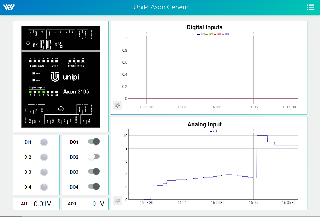

5.1 Control UniPi Patron from HMI
The project contains graphical user interface (so-called Human-Machine-Interface) for easy control and observing of general outputs and inputs. The HMI can be found at URL address http://192.168.1.100:8008/hmi/index.html (replace 192.168.1.100 with the IP address of your UniPi Patron).

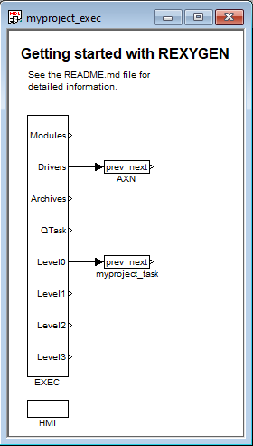

The process of creating a control algorithm will be demonstrated on a very simple example with four Boolean variables representing manual switches. In Chapter 7.3, two of them will be replaced by physical inputs of the UniPi Patron. A software timer will be used for measuring the time when the variables are true (i.e. the switches are in the ON position). A Boolean signal will indicate that the interval of predefined length has elapsed.
6.1 Creating a new project
6.2 Compiling and running a project

6.3 Adding a user interface (HMI)
moment. See [5] for details, it is a very interesting tool for developers and
- See [5] for detailed information about WebBuDi elements and possible customization (colors, backgrounds etc.).
- The default URL address is http://192.168.1.100:8008/hmi/index.html (replace 192.168.1.100 with the IP address of your UniPi Patron).

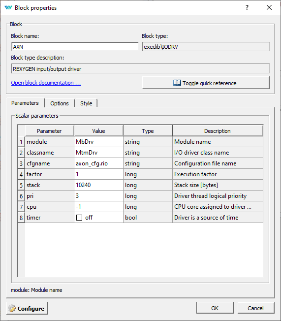

Now we tell the compiler to use the UniPi Patron I/O driver. To do this, edit the IODRV block parameters. Communication will be mediated using Modbus TCP. Link the IODRV block with the MBDrv (Modbus) module by setting
- (beware, it’s CASE SENSITIVE!)
Continue editing the IODRV block parameters. For UniPi Patron set the following:
As the final step, rename the IODRV block to AXN, which will serve as a prefix for all I/O signals of this driver.

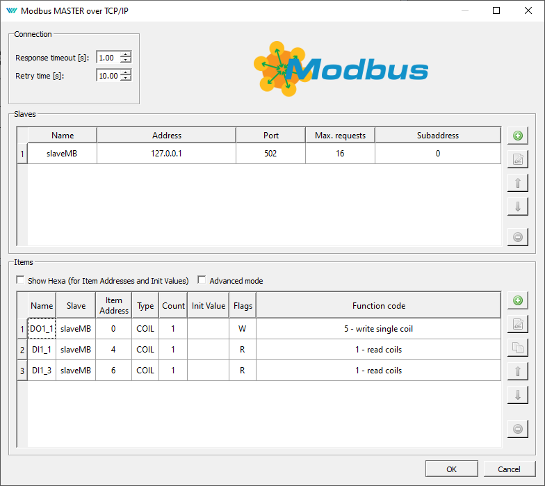

You have to create the axon_cfg.rio file. Click on Configure button and fill the form as shown bellow. After that, click on OK and the file will be stored in the project folder.

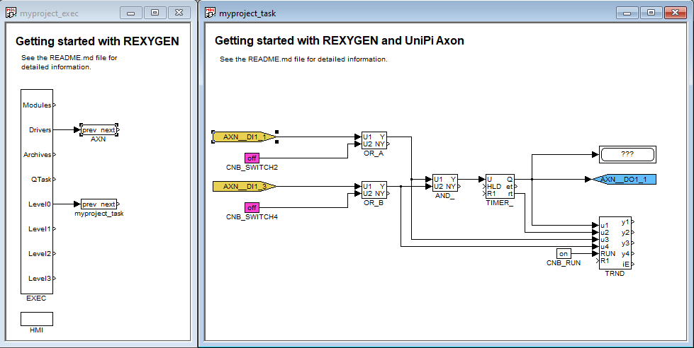

7.3.2 Modifications in the task

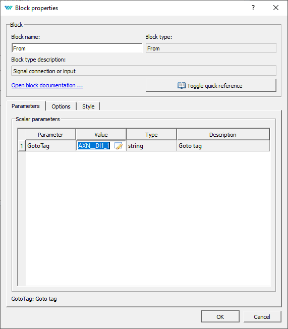

In the task double-click the input flag and set . Note the AXN prefix and two underscore characters. The first physical switch (SW1) is connected to first group of Digital Inputs - input 1.
The other physical switch (SW3) is connected to Digital Input 1.3 (AXN__DI1_3). The last (Digital Output) flag will be set as
After compiling the project and downloading it to the UniPi Patron the control algorithm interacts with the physical world. Again it is possible to switch to Watch mode and observe the signals in real-time or analyze the trends of signals. Flip the physical switches and watch the signals.

A detailed description of the Modbus TCP IO driver which serves as communication platform for UniPi Patron is available in a separate manual [6].
