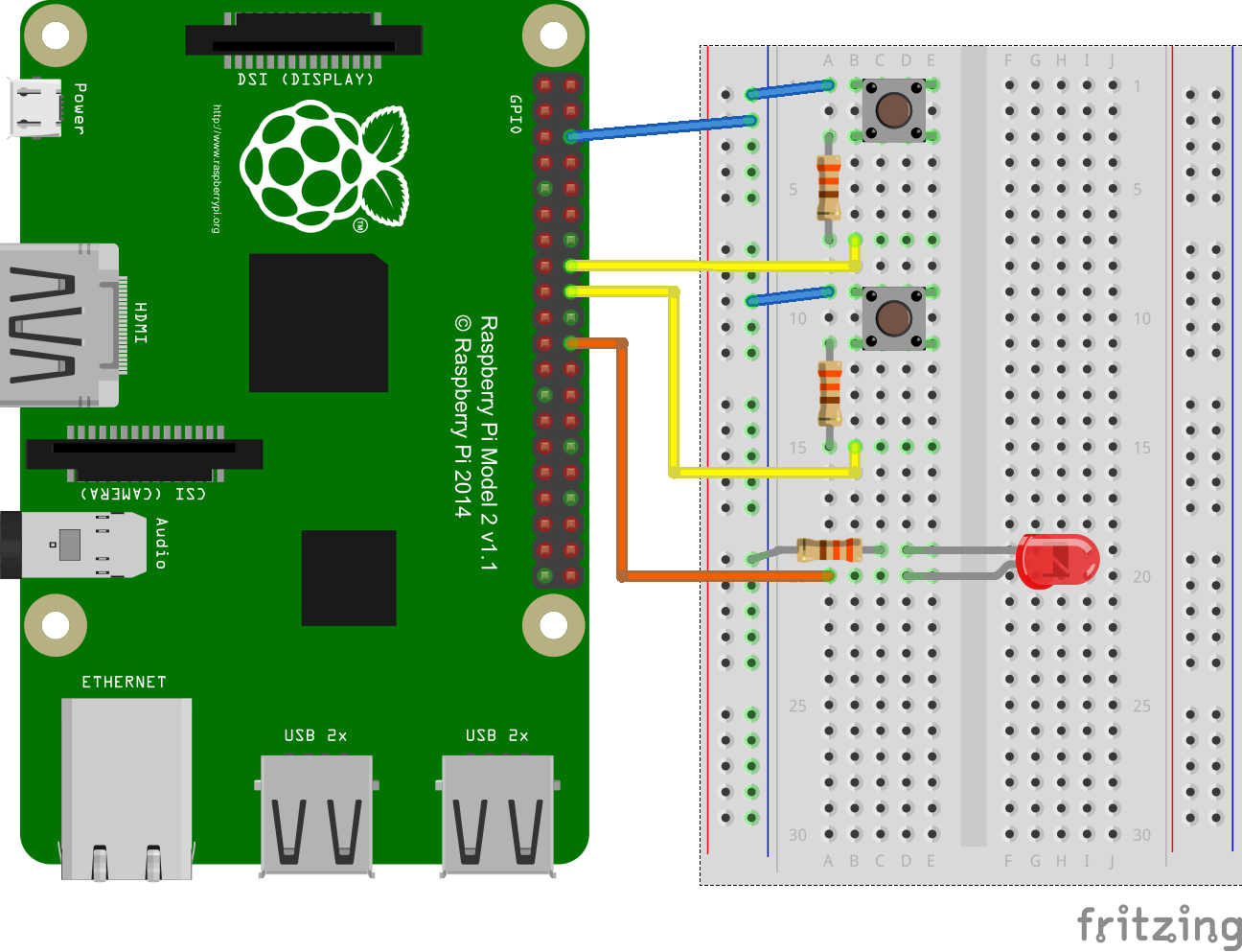

We will use the GPIO pins of the Raspberry Pi for interaction with the real world. The pins can be configured as inputs or outputs.
As mentioned in Chapter 4, two physical switches will be connected as inputs and a software timer will control one output signal. In other words, this chapter is devoted to advancing from the generic example 0101-01 to example 0120-01 for the Raspberry Pi.
5.1 Physical connections
Connect the switches, protective resistors (330 Ohm) and a LED indicator as shown below.

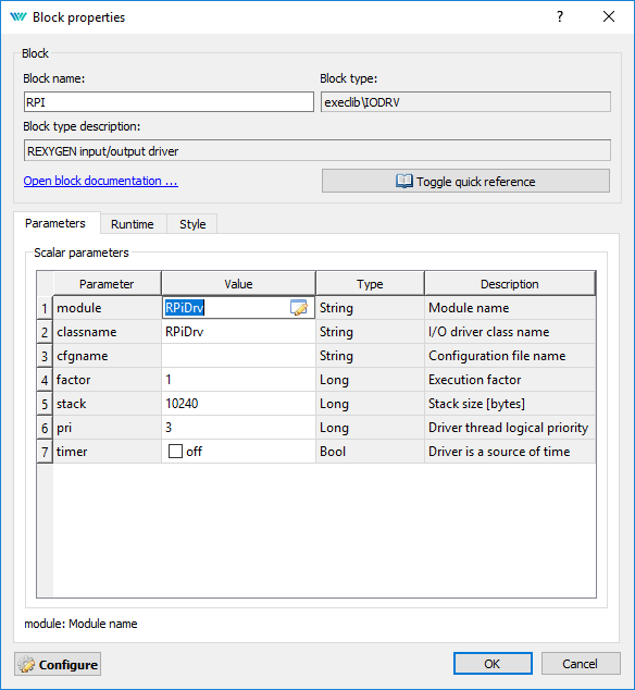

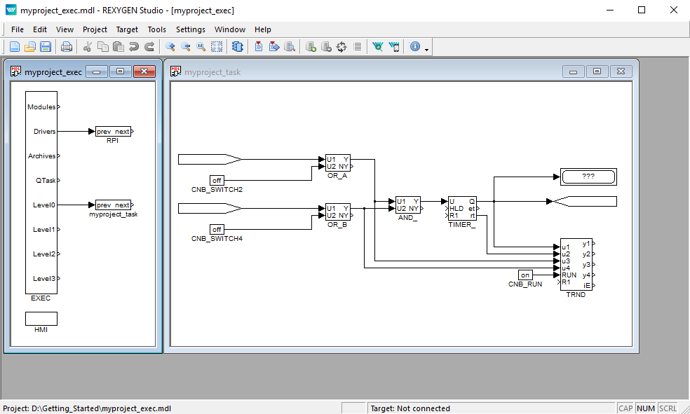

Now we tell the compiler to use the Raspberry Pi I/O driver. To do this, edit the IODRV block parameters. Link the IODRV block with the RPiDrv module by setting
- – CASE SENSITIVE!
Continue editing the IODRV block parameters. For bare Raspberry Pi set the following:
- – CASE SENSITIVE!
- Leave the cfgname parameter blank.
As the final step, rename the IODRV block to RPI, which will serve as a prefix for all I/O signals of this driver.
5.3.2 Modifications in the task

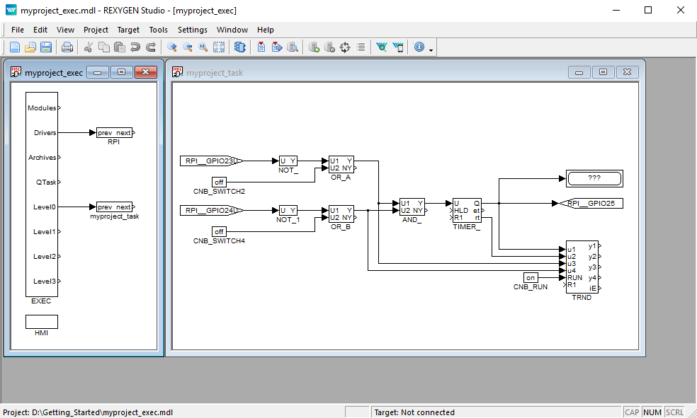

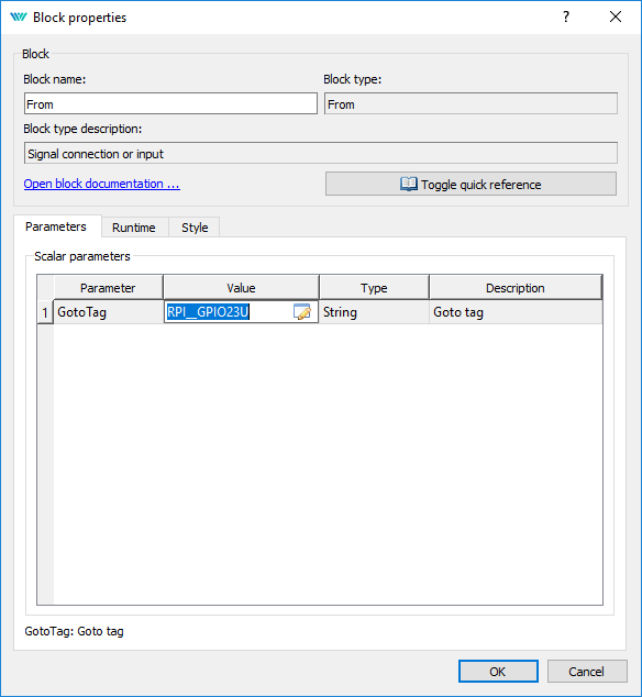

In the task double-click the input flag and set . Note the RPI prefix and two underscore characters. The first physical switch will be connected to GPIO#23 and an internal pull-up resistor will be activated.
The second physical switch will be connected to GPIO#24 (RPI__GPIO24U).
Note that the logic of the inputs is reversed by adding the NOT function blocks. Simply drag them from the library and drop them on the existing line.
The timer output will be routed to GPIO#25 and it will serve as the output signal (RPI__GPIO25).

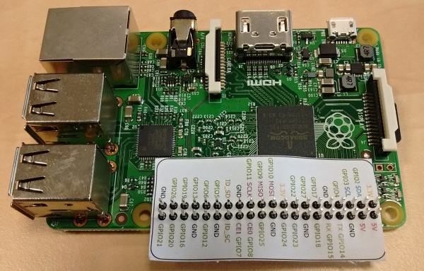

The pin numbering on Raspberry Pi B+, 2 and 3 is shown in the following pictures:
Visit the http://elinux.org/RPi_Low-level_peripherals webpage for detailed information about individual GPIO pins.

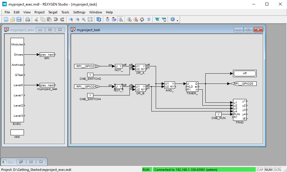

After compiling the project and downloading it to the Raspberry Pi the control algorithm interacts with the physical world. Again it is possible to switch to Watch mode and observe the signals in real-time or analyze the trends of signals. Flip the physical switches and watch the signals.
