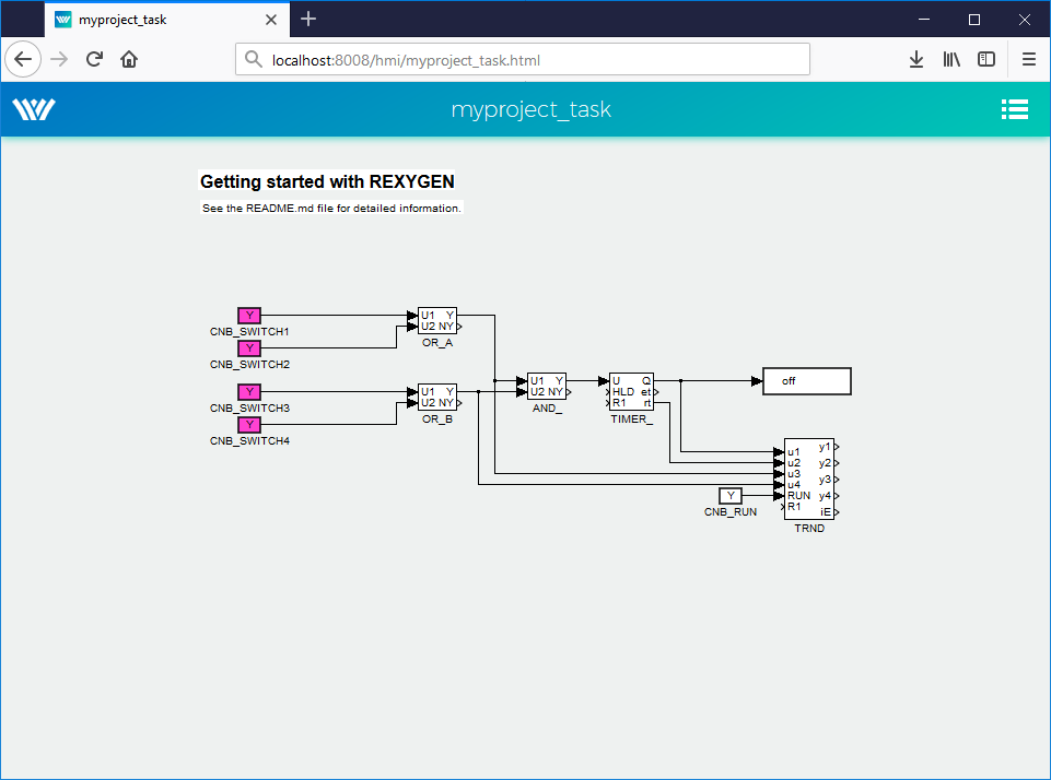

WebWatch
2.1 Automatic Generation of HMI from REXYGEN Studio

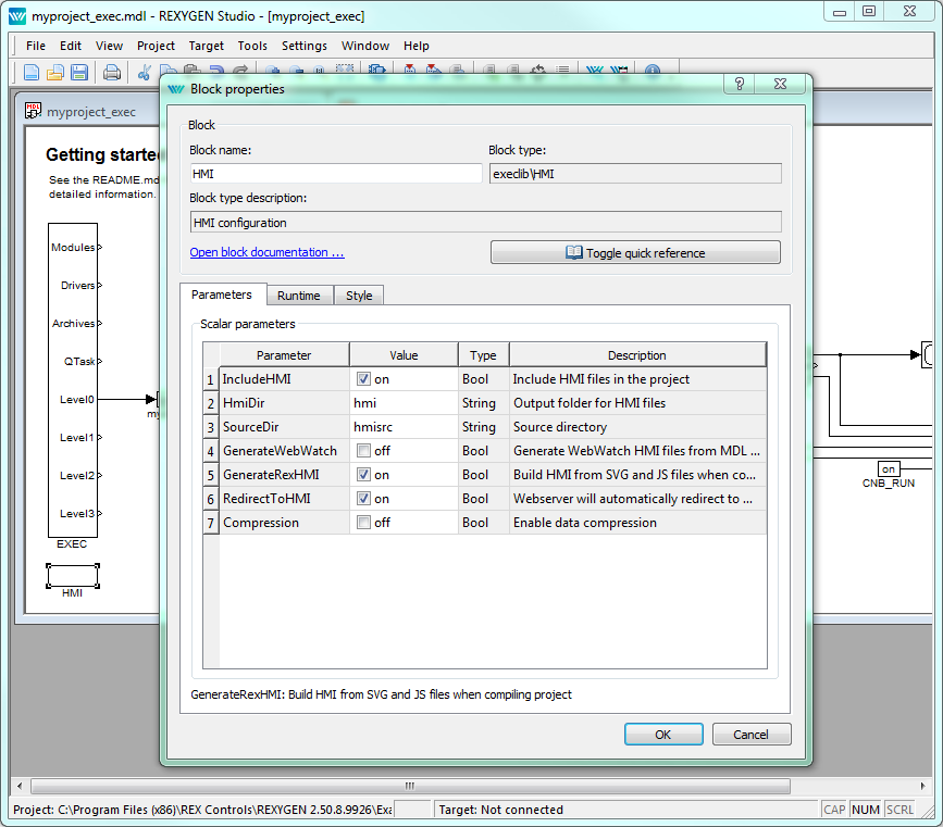

WebWatch is automatically generated HMI based on the project structure. It is similar to the Watch mode in REXYGEN Studio. The whole scheme is generated to web page. User can monitor all signals from selected blocks, change block parameters and read the data from TRND blocks. The WebWatch is generated automatically using HMI block in project main file.
- Insert HMI block to the exec.mdl file of your project.
- Check GenerateWebWatch and IncludeHMI to enable WebWatch generation.
- Run Compile and Download.
- Open the web browser and navigate to your target device eg. http://192.168.1.100:8008/hmi.
- Use left mouse click (touch) for changing the block parameters and right mouse click (long touch) for enabling the block monitoring.

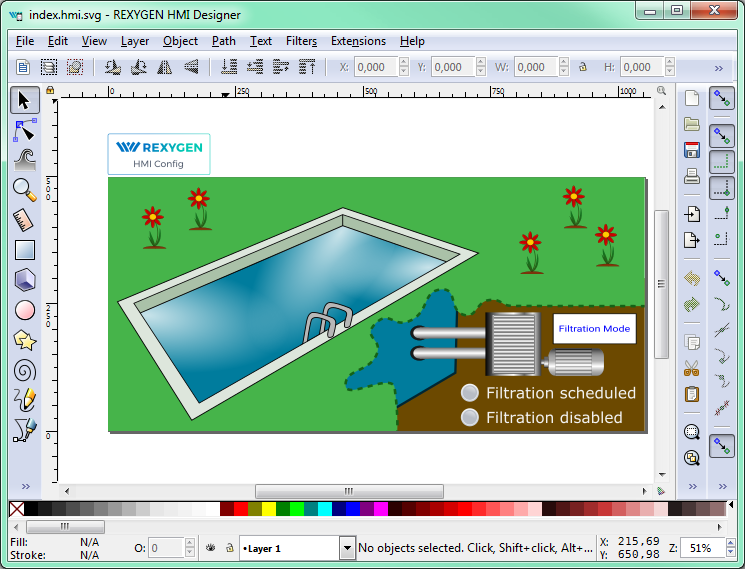

3.1 A Graphical Designer of Web HMI

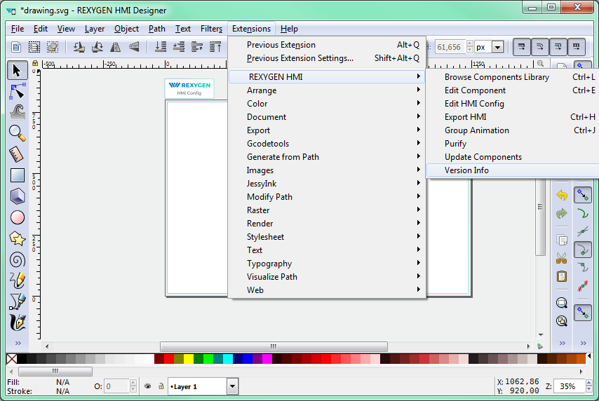

REXYGEN HMI Designer (The REXYGEN HMI Designer is build on the well-known SVG editor InkscapeTM https://inkscape.org/en/.) is tool for designing the custom visualizations using predefined components. The whole HMI is stored in the SVG (Scalable Vector Graphics) file with REXYGEN specific extensions.
When the visualization is ready the HTML page with all necessary libraries is generated. Such a webpage can be easily generated and downloaded to the target device from ./hmi directory using Compile and Download function of the REXYGEN Studio development tool.
Each HMI scheme composes from several components which are connected to the signals from the control system. These components are organized in libraries. The example HMI on fig. 3.1 contain one Button, two LEDs and several GeneralComponents for pool and flower animations.
The HMI components are controlled via extensions (on fig. 3.2) which edit the REXYGEN HMI specific parameters and allow the export of the final HMI. There are following extensions:
- Browse Components Library (Ctrl + L) – Open the folder with all available components. Each component is stored as a SVG file which can be drag&dropped to the current HMI
- Edit Component (Ctrl + E) – Open edit window for the selected component or for the whole project if nothing is selected.
- Edit HMI Config – Open edit window for the general HMI configuration.
- Export HMI (Ctrl + H) – Exports the content of the SVG file to the HTML5 webpage with all necessary libraries. This extension is configured via parameters of the whole project.
- Group Animation (Ctrl + J) – Enable animation of the transformations (translation, rotation, scale), opacity or color of the selected object (SVG group) based on the values from the control system. Or you can use the extension to create clickable button.
- Purify – Finds all invalid component in the document a removes them. The component is invalid either if does not contain any valid JSON configuration or visible content like rectangles, texts, etc.
- Update Components – Extension for updating the schema to new version
- Version Info – Show current version of the REXYGEN HMI Designer and HMI tools.

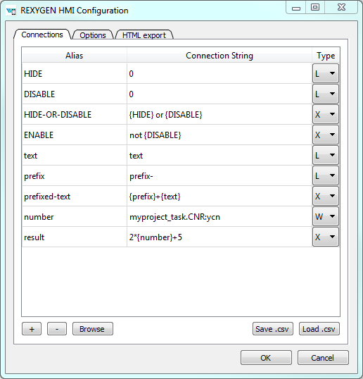

3.2.1 Connections tab
The connection tab contains table maps between an Alias (the name of the data point in HMI) and connection string (the path where the value is read or written form the REXYGEN). Each connection can have one of two types:
- R – Read item, the values are read from the target,
- W – Write item, the value can be written to the target after change.
There are two more special types the
- L – Local item,
- X – Expression item (will be described later).
When the HMI Config is opened the Aliases of the data points used in the HMI components are loaded automatically. Also the R or W type is selected based on the type of the component (e.g. The Button value data point will point to the W rite connection, but Led value will point to the Read one). For these connections just use the browse function to fill the connection string.
Press Browse button. The login dialog will be opened. Unless you changed the login credentials, use the default username admin with an empty password. After a successful login the connection tab is expanded with a tree-view of the running algorithm. Select Connection String field of the selected Alias and afterwards browse the tree to the desired block and double-click the parameter. The connection string of the parameter is copied to the alias. Follow this procedure to fill all the R and W connections. For basic example see [1].
The Local connection type (L) represents a variable. User can define custom item which can be read or written using standard HMI components. The default value is set using Connection string field. The Local item is available only for current webpage. So if you refresh the webpage or open new one in different tab the default value is loaded.
The Expression connection type (X) is used for evaluation expression above other aliases. The alias is read only and updates whenever any of the selected items change. The alias name used in the expression is surrounded by curly brackets. For example:
The available operations are:
- Arithmetic – +, -, *, /, %
- Bitwise – not (~), and (&), or (|), xor (^|)
- Shift – left (<<), right (>>), right logical (>>>)
- Logical – not, and, or, xor
- Relations – ==, !=, <, >, <=, >=
- Constants – pi, e, true, false, null
The expression can point to item type. It can contain constants such as numbers or strings. The type of value is set based on the type of value from used connection. If the expression cannot be evaluated, you will se error log message in the HMI webpage. You can also use expression to concat strings. The example of simple usage of local and expression types is shown in the following figure 3.3.
Note: If expression item points to another expression item the target item MUST be always defined before. The items are sorted alphabetically based on the used Alias so the target item must have proper name.

REX.HMI library
5.1 How to Use the Library
The user can program the HMI over REX.HMI interface. It contain several public methods for reading and writing items from REXYGEN targets. To create and build your custom HMI based on the RexHMI library follow these steps:
- Create project directory with exec.mdl. Add the HMI block to the executive (see the [2] for more details).
- Create *.hmi.js file in ./hmisrc directory with REX.HMI.init = function(){} function inside.
- Start writing your script.
When the script is ready, enable generation of RexHMI using GenerateRexHMI parameter in the HMI block of the executive. Then run Compile and Download function in the REXYGEN Studio. The content of the *.hmi.js file is inserted to the RexHMI template with all the necessary scripts and libraries, also all other content of the hmisrc directory is copied to the target ./hmi folder. The HMI is then downloaded to the target and available from the internal webserver.
The REX.HMI interface is described in following sections. Each function contain short example with common parameters.
2// Append this function to the HTML document or use predefined placeholder in the template
3REX.HMI.init = function(){
4// Change some basic settings
5
6}
