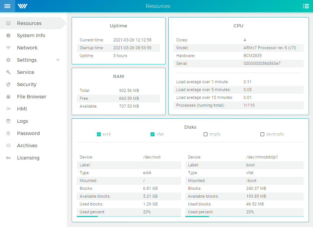

After successful installation, REXYGEN DWM should be accessible on address
http://device-IP-address/dwm (use the IP of your device). If everything went well, you
should see the environment from the Figure 1.1. The environment is divided into several
sections (screens) which are described bellow. This pre-defined menu can be configured if
needed. See the Chapter 4.2 for more details.
3.1 Resources
This section is for informational purposes only and shows:
- Uptime,
- CPU information,
- current RAM and CPU load,
- memory devices information and its current usage.
