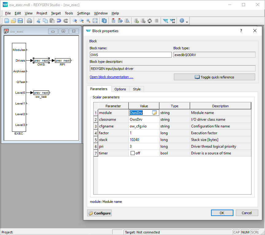

The driver is included in the project as soon as the driver is added to the project main file and the inputs and outputs are connected in the control algorithms.
2.1 Adding the OwsDrv driver
The project main file with the OwsDrv driver included is shown in Figure 2.1.
There is one block which must be added to the project to include the driver. A block of type IODRV renamed to OWS and connected to the Drivers output of the main EXEC block. The name of this block (OWS, see Fig. 2.1), is the prefix of all input and output signals provided by this driver. The three most important parameters are:
- module – Name of the module linked to the driver, in this case OwsDrv. The name is CASE SENSITIVE!
- classname – Class of the driver, in this case OwsDrv. The name is CASE SENSITIVE!
- cfgname – Name of the driver configuration file (*.rio, REXYGEN Input/Output). It is a simple text file which is automatically created when necessary. It can have arbitrary name (here ow_cfg.rio). The configuration is further discussed in chapter 3.
The above mentioned parameters of the IODRV function block are configured in REXYGEN Studioprogram. The configuration dialog is shown also in Fig. 2.1.

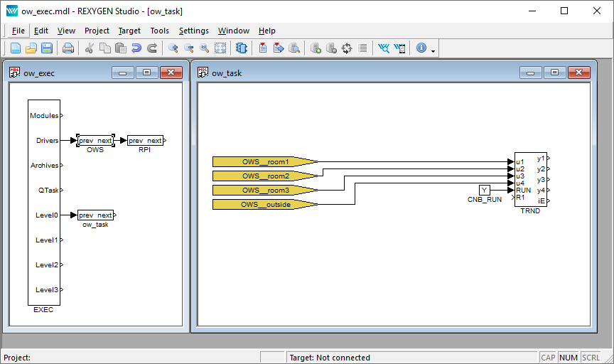

2.2 Connecting the signals in the algorithm
The input and output signals of the driver must be interconnected with the individual tasks (.mdl files). The individual tasks (QTASK or TASK blocks) are connected to the QTask, Level0,…, Level3 outputs of the main EXEC block.
The inputs and outputs of the OwsDrv driver can be accessed as shown in Fig. 2.2.
The From block allowing the user to read one input signal has the Goto tag set to OWS__temperature. The Goto block allowing the user to set one output signal would have the Goto tag set to OWS__name. The blocks always have the OWS prefix right at the beginning of the tag followed by two _ characters (underscore).

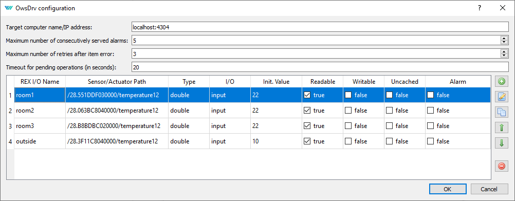

The configuration dialog shown in Fig. 3.1 is part of the OwsDrv_H.dll file. It can be activated from REXYGEN Studio by pressing the Configure button in the parameters dialog of the IODRV block (see chapter 2).
The upper part of the dialog defines the connection to the owserver. The owserver typically runs on the same machine as RexCore but it is not a rule.

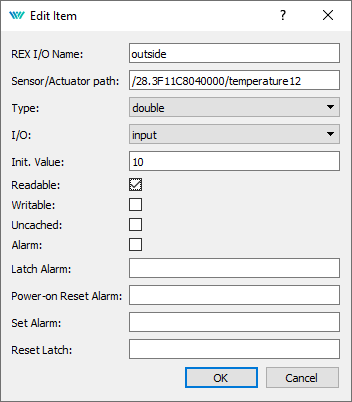

The individual signals to read or write from the REXYGEN control algorithm are defined in the lower part of the configuration dialog. Simply add the signals, use the device IDs displayed by the owdir command.
For an output signal (in the I/O column the output is selected), the Value is once written to the output if it is not overwritten from the control algorithm.
The signal table in the driver configuration dialog is processed cyclically during the run-time in the following way. Each output signal which has been changed since the last write is written with the value. Similarly, all input signals are being cyclically read in the same order. When a large number of inputs is configured the reading of the whole table can take quite a long time. Therefore, the owserver program allows to indicate signal changes as so called alarms in the /alarm directory, see section 3.2. This driver is able to process alarms from REXYGEN version 2.5.
Moreover, if the Uncached option is checked then the given signal will be always read directly from the connected integrated circuit (e.g. from the thermometer). If the Uncached is not checked then the returned value will be read from the cache memory which is typically updated each 15 seconds. Note: The more signals has chosen Uncached, the slower the response of this driver.

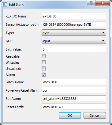

Work with alarms belongs among the advanced techniques and requires good knowledge of owfs and the owserver. It is recommended to use alarms only when the 1-Wire driver response is too slow.
Configuration of one alarm in the case of DS2408 circuit based 1-Wire device is shown in Fig. 3.3. The path to the signal (Sensor/Actuator path) is entered without starting directory /alarm. After selecting the Alarm, additional strings should be entered. The configured string values are preprocessed and stored to working string variables for each alarm (before start of the driver):
- sPath – path to the device, here: /29.066418000000. For reading or writing values, the /alarm directory can be inserted before this path, and the character / and the value of some of the preprocessed strings (see next items) can be appended after this path
- sSensed – file with the value to be read, here: sensed.BYTE
- sLatch – file with the sensed value change flag(s), here: latch.BYTE
- sAlarmPor – file indicating the power-on reset of the device, here: por
- sSet – file, to which should be written the configuration of next alarm generation (first part of the Set Alarm item to the character =), here: set_alarm
- sSetVal – value, which should be written to the sSet file (second part of the Set Alarm item from the character =), here: 133333333
- sLatchRes – file, to which should be written the value indicating that the alarm has been served (first part of the Reset Latch item to the character =), here: latch.BYTE
- sLatchResVal – value, which should be written to the sLatchRes file (second part of the Reset Latch item from the character =), here: 0
