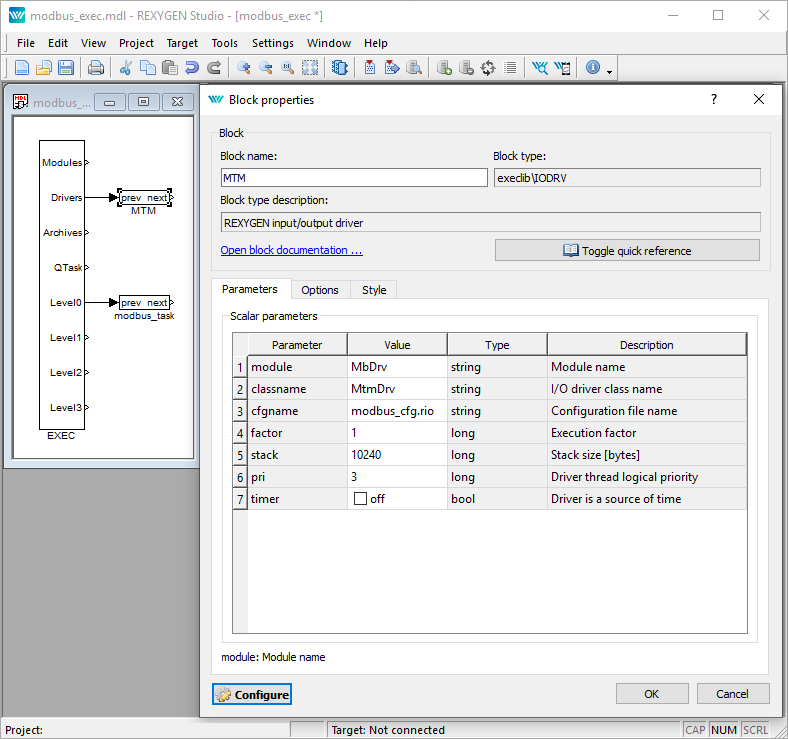

2.1 Adding the MbDrv driver
The project main file with the MbDrv driver included is shown in Figure 2.1. The Modbus Master of the TCP/IP version is shown.
There is one block which must be added to the project to include the driver. A block of type IODRV renamed to MTM and connected to the Drivers output of the main EXEC block. The name of this block (MTM, see Fig. 2.1), is the prefix of all input and output signals provided by this driver. The three most important parameters are:
- module – name of the module linked to the driver, in this case MbDrv – the name is CASE SENSITIVE!
- classname – class of the driver, which defines the role of the target device and the
Modbus version to use:
- MbmDrv – for Modbus RTU Master
- MbsDrv – for Modbus RTUSlave
- MtmDrv – for Modbus TCP/IP Master
- MtsDrv – for Modbus TCP/IP Slave
The name is CASE SENSITIVE!
- cfgname – name of the driver configuration file (*.rio, REXYGEN Input/Output file), which is discussed in chapter 3
The name of this block (MTM, see Fig. 2.1), is the prefix of all input and output signals provided by this driver for Modbus TCP/IP Master. Similarly, the IODRV block can be named MTS, MBM and MBS for TCP/IP Slave, RTU Master and RTU Slave.
The above mentioned parameters of the IODRV function block are configured in the REXYGEN Studio program. The configuration dialog is shown also in Fig. 2.1.
The Configure button opens the configuration dialog of the MbDrv driver, which is described in chapter 3.

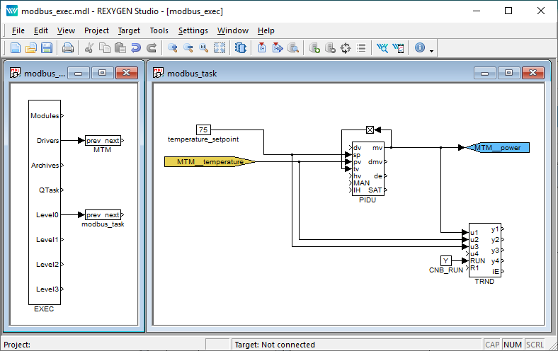

2.2 Connecting the inputs and outputs in the control algorithm
The inputs and outputs of the driver must be interconnected with the individual tasks (.mdl files). The individual tasks (QTASK or TASK blocks) are connected to the QTask, Level0,…, Level3 outputs of the main EXEC block. Use the blocks depicted in Fig. 2.2 to interchange data between the control algorithm and the MbDrv driver.
Figure 2.3 shows an example of a PID control loop with one input (temperature) and one output (power) signal provided by the MbDrv driver.
The From block allowing the user to read one input signal has the Goto tag set to MTM__temperature. The Goto block allowing the user to set one output signal has the Goto tag set to MTM__power. The blocks always have the MTM prefix right at the beginning of the tag followed by two __ underscore. The blocks with multiple inputs/outputs have this prefix directly in their name.
The use of multi-input/output blocks is recommended if data exchange rate (sampling frequency) is the priority. See the function block reference manual [3] for details about INOCT, OUTOCT, INHEXD, OUTHEXD blocks.

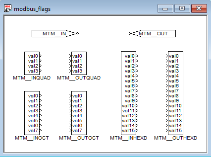

Example project with input and output flags for the MbDrv driver are prepared by default
in the folder
C:\Program Files\REX Controls\REX <version>\Examples\Modbus_examples\00_IO_Flags.

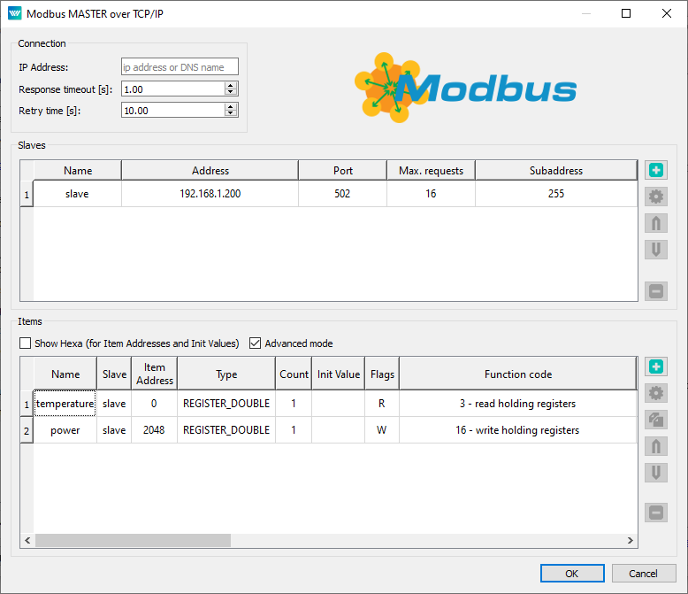

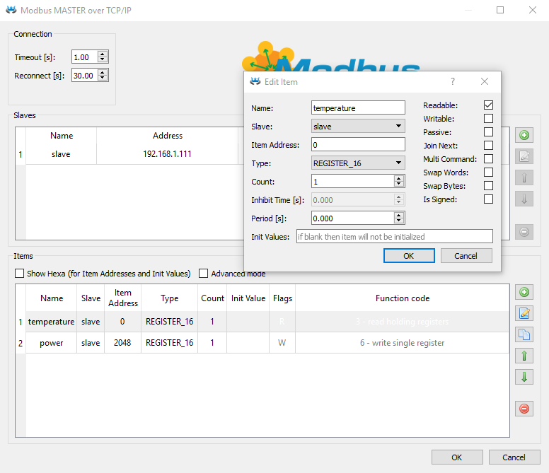

3.1.1 Modbus TCP/IP Master configuration
The configuration dialog is shown in Figure 3.1.
The upper left part of the dialog contains Connection parameters. Namely:
- Response timeout – Maximal time (in seconds) to wait for the response from Slave station. The station is considered malfunctioning if no valid response is received.
- Retry time – Time interval (in seconds) for testing the malfunctioning stations.
- IP Address – Address of the configured Master. To be filled in when more than one Master is running on one device. Otherwise, leave blank. Special value 0.0.0.0 is used for activation of the protocol on all local IP addresses. This field is only available in Advanced mode.
If the REXYGEN system acts as TCP/IP Master, it is necessary to define the Slave stations. The center part of dialog depicted in Fig. 3.1 displays the defined Slave stations. New Slave station can be added by pressing Add slave in the right column. Existing slaves can be edited directly in the Slave list or by pressing Edit slave button.
Following parameters define slave device:
- Name – A unique station name.
- Address – IP address of the Slave station.
- Port – Port (TCP address) of the Slave station. The default port for Modbus is 502.
- Max requests – Maximum number of Modbus telegrams in the queue. Especially the embedded devices with limited memory usually have a small TCP/IP stack buffer. The Master station tracks the requests and responses of each Slave station and postpones the requests if the Slave station fails to respond in a timely manner.
- Subaddress – An extra address field is available with values ranging from 1 to 255. The value 0 is reserved for broadcast purposes, meaning that all subslaves can receive the data, but none should respond. Unless there is a specific reason to do so, it’s advisable not to use the value 0. The value 255 indicates that the slave station does not use subaddressing.

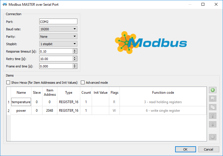

3.1.2 Modbus RTU Master configuration
The configuration dialog is shown in Figure 3.2.
- Port – The serial line used for communication. Usually COM* for Windows target devices or /dev/ttyS* for Linux target devices. Replace "*" symbol according to the chosen serial port! Starting from REXYGEN version 3.0, it is possible to enter virtual ports as well. More information about virtual ports can be found in the Function Blocks Reference manual in the description of the UART block.
- Baud rate – All stations on one bus must use the same baud rate. In bits per second.
- Parity – The error checking mechanism. All stations on one bus must use the same parity.
- Stopbit – Number of stop bits sent at the end of every character. All stations on one bus must use the same value.
- Response timeout – Maximal time (in seconds, default 0.1 s) to wait for the 1st byte of response frame from Slave station after the request was sent out completely. The station is considered malfunctioning if no valid response is received 3 times in a row. Do not use long timeouts, especially when there are multiple Slave stations on the bus. In case of a malfunctioning station it is not possible to communicate with other stations for the whole timeout period.
- Retry time – Time interval (in seconds, default 10 s) to wait before retrying communication with malfunctioning stations.
- Frame end time – How long silence time on the line is considered as the frame end. Value 0 means automatic configuration based on baud rate according to Modbus specification (3.5 characters) with some safety margin for processing in the operating system. Please try to increase this value up to the value of Response timeout parameter if you are facing Read serial device timed out errors in system log.

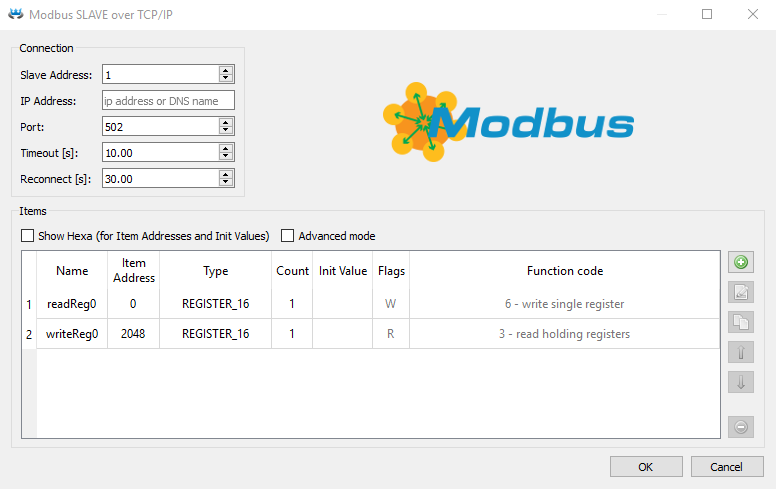

3.2.1 Modbus TCP/IP Slave configuration
The configuration dialog is shown in Figure 3.3.
- Slave address – Slave device address. There can be up to 254 Slave stations on same IP address. The address 0 is reserved for broadcast and must not be used. The address 255 indicates that the subaddress is ignored.
- IP Address – Defines the network adapter where the Slave is listening. Leave it blank or set it to value 0.0.0.0 for all network adapters or specify IP Address of a chosen one.

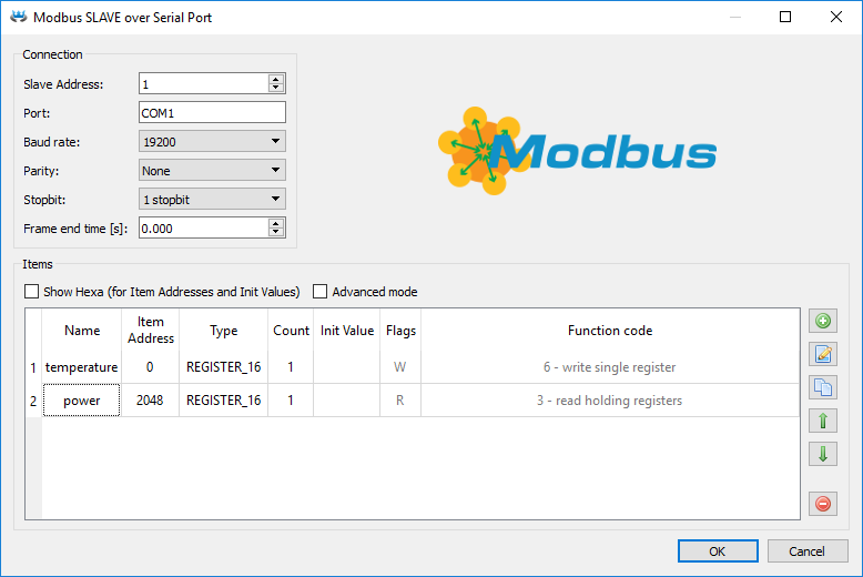

3.2.2 Modbus RTU Slave configuration
The configuration dialog is shown in Figure 3.4.
- Slave address – To specify a slave device, its address must be determined. Up to 254 Slave stations can be connected, but without a repeater, only up to 32 stations can be accommodated. The address 0 is reserved for broadcasting and should not be used. In the TCP version, the address 255 has a specific meaning and should be avoided.
3.3 Modbus items configuration
The configuration dialog is shown in Figure 3.5.
The lower part of the configuration dialog displays the configured signals. Each line has a symbolic name and corresponds to one signal or a group of signals. New item can be added by pressing the Add item button in the right column of the configuration dialog. The item can be similarly edited by pressing the Edit item button. Some of the parameters (Name, Item Address, Type and Count) can be edited directly in the Item list. If you choose Advanced mode it unlocks all other parameters for direct edit in the Item list.
The individual columns have the following meaning:
- Name – A unique signal name.
- Slave – Select slave device. Available only in Modbus TCP/IP Master item configuration.
- Slave Address – Slave device address. Available only for Modbus RTU Master item configuration.
- Item Address – Address of the object in the device. All objects (values) within one station have an identification number (address) from the range 0 to 65535.
- Type – Signal type. The names respect the Modbus specification:
Input Digital input Coil Digital output InReg 16 16-bit integer number 0…65535 or -32768…32767 (depend on Is Signed flag), InReg 32 32-bit integer number 0…4294967296 or -2147483648…2147483647 (depend on Is Signed flag), InReg 64 64-bit integer number -9223372036854775808…9223372036854775807 (unsigned is not supported), InReg float 4-byte floating point number (Is Signed flag is ignored), InReg double 8-byte floating point number (Is Signed flag is ignored), Register 16 16-bit integer number 0…65535 or -32768…32767 (depend on Is Signed flag), Register 32 32-bit integer number 0…4294967296 or -2147483648…2147483647 (depend on Is Signed flag), Register 64 64-bit integer number -9223372036854775808…9223372036854775807 (unsigned is not supported), Register float 4-byte floating point number (Is Signed flag is ignored), Register double 8-byte floating point number (Is Signed flag is ignored), Register string text variable (Count is number of bytes occupied by text in this case) Note: REGISTER is called Holding Register and INREG is called Input Register by some vendors.
- Count – Number of values. One item can represent a group of values which are read at once using the multi-input/output block. This number defines how many values to read. The number does not necessarily correlate with the number of inputs/outputs of the block. In such a case, the unused pins are not updated.
- Inhibit Time – Valid only for Writable (W) items. Defines the minimum length of time that must be allowed to elapse between the transmissions of the item.
- Period – Refresh period in seconds. Nonzero values define the period, zero respects the period given by the corresponding IODRV block.
- Initial value – The initial value to set the signal to when initializing the driver. Use square brackets for groups of values. Separate the values by spaces.
- Readable (R) – Tick this checkbox to allow reading of the value in the REXYGEN algorithm. In Slave configuration, such items will be writable for the Master.
- Writable (W) – Tick this checkbox to allow writing of the value from the REXYGEN algorithm. In Slave configuration, such items will be readable for the Master.
- Passive (P) – In some cases it is more efficient to transmit a large group of signals at once (maximum is 125 values). But we still want to work with individual signals or less populated groups in the algorithm. In that case we define one big array and a number of small groups overlaying the data registers. Only the big array is active, the other signals are set to passive. This field is available only in the Master configuration.
- Join next (J) – Tick this checkbox to use the read-write command of the Modbus specification. The readable signal is joined with its successor (the writable item one line below) and the data is exchanged using a single command. This field is available only in the Master configuration.
- Multi command (m) – Tick this checkbox to force multi-read or multi-write command even if only one value is transmitted. Useful for Modbus stations supporting only a subset of Modbus commands. This field is available only in the Master configuration.
- Swap word (a) – 32-bit numbers are represented by 2 successive 16-bit numbers in Modbus. This flag defines the order of lower and upper word. The same holds for real numbers as they are represented by 2 or 4 successive 16-bit registers.
- Swap byte (b) – The upper byte of the 16-bit number is transmitted first in Modbus (the so-called big-endian format). However, some devices use little-endian implementation. This flag becomes handy in such a case.
- Is Signed (S) – Tick this checkbox to treat the integer number as a signed number.
- As Array (V) – The values are transmitted to the REXYGEN algorithm in the form of an array. If multiple values are involved, a From block is utilized to connect the array signal from the driver, along with one or more VTOR blocks.
