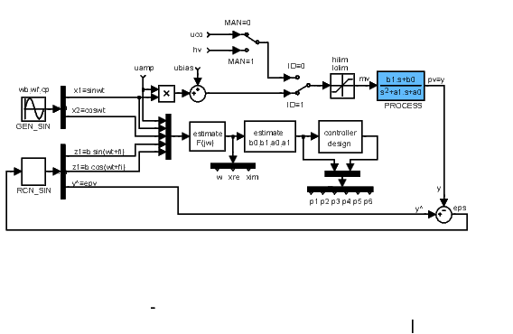

The "Identification and design mode" is activated by the binary input . Two points of frequency response with given phase delay are measured during the identification experiment. Based on these two points a model of the controlled system is built. The experiment itself is initiated by the rising edge of the RUN input. A harmonic signal with amplitude uamp, frequency and bias ubias then appears at the output mv. The frequency runs through the interval , it increases gradually. The current frequency is copied to the output w. The rate at which the frequency changes (sweeping) is determined by the cp parameter, which defines the relative shrinking of the initial period of the exciting sine wave in time , thus
The cp parameter usually lies within the interval
. The lower the
damping coefficient
of the controlled system is, the closer to one the cp parameter must be.
At the beginning of the identification period the exciting signal has a frequency of . After a period of stime seconds the estimation of current frequency response point starts. Its real and imaginary parts are available at the xre and xim outputs. If the MANF parameter is set to 0, then the frequency sweeping is stopped two times during the identification period. This happens when points with phase delay of ph1 and ph2 are reached for the first time. The breaks are stime seconds long. Default phase delay values are and , respectively, but these can be changed to arbitrary values within the interval , where . At the end of each break an arithmetic average is computed from the last iavg frequency point estimates. Thus we get two points of frequency response which are successively used to compute the controlled process model in the form of (7.4). If the MANF parameter is set to 1, then the selection of two frequency response points is manual. To select the frequency, set the input , which stops the frequency sweeping. The identification experiment continues after returning the input HLD to 0. The remaining functionality is unchanged.
It is possible to terminate the identification experiment prematurely in case of necessity by the input . If the two points of frequency response are already identified at that moment, the controller parameters are designed in a standard way. Otherwise the controller design cannot be performed and the identification error is indicated by the output signal .
The IDBSY output is set to 1 during the "identification and design" phase. It is set back to 0 after the identification experiment finishes. A successful controller design is indicated by the output . During the identification experiment the output iIDE displays the individual phases of the identification: means approaching the first point, means the break at the first point, means approaching the second point, means the break at the second point and means the last phase after leaving the second frequency response point. An error during the identification phase is indicated by the output and the output iIDE provides more information about the error.
The computed state controller parameters are taken over by the control algorithm as soon as the SETC input is set to 1 (i.e. immediately if SETC is constantly set to on). The identified model and controller parameters can be obtained from the p1, p2, …, p6 outputs after setting the ips input to the appropriate value. After a successful identification it is possible to generate the frequency response of the controlled system model, which is initiated by a rising edge at the MFR input. The frequency response can be read from the w, xre and xim outputs, which allows easy confrontation of the model and the measured data.
The "Controller mode" (binary input ) has manual () and automatic () submodes. After a cold start of the block with the input it is assumed that the block parameters mb0, mb1, ma0 and ma1 reflect formerly identified coefficients , , and of the controlled system transfer function and the state controller design is performed automatically. Moreover if the controller is in the automatic mode and , then the control law uses the parameters from the very beginning. In this way the identification phase can be skipped when starting the block repeatedly.

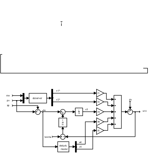

The diagram above is a simplified inner structure of the frequency autotuning part of the controller. The diagram below shows the state feedback, observer and integrator anti-wind-up. The diagram does not show the fact, that the controller design block automatically adjusts the observer and state feedback parameters after identification experiment (and ).
