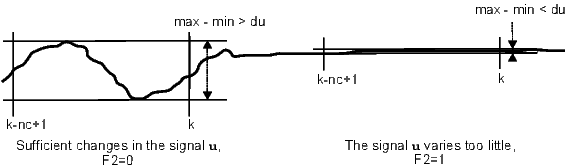

- F2: The input signal u varies too little. The last nc samples of the input u lies within the
interval of width du,
where vmin and vmax are the lower and upper limits of the input u, respectively, and nbits is the number of A/D converter bits. The situation when the input signal u varies too little is shown in the following picture:
If the parameter nc is set to , the condition F2 is never fulfilled.

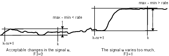

- F3: The input signal u varies too much. The last nr samples of the input u filtered by the
SPIKE filter have a span which is greater than rate,
where prate defines the allowed percentage change in the input signal u within the last nr samples (with respect to the overall range of the input signal ). The block includes a SPIKE filter with fixed parameters and suppressing peaks in the input signal to avoid undesirable fulfilling of this condition. See the SPIKE block description for more details. The situation when the input signal u varies too much is shown in the following picture:
If the parameter nr is set to , the condition F3 is never fulfilled.
