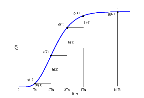

The prediction is based on the discrete step response is used. The figure above shows how to obtain the discrete step response and the discrete impulse response with sampling period from continuous step response. Note that must be chosen such that , where is the time to reach 95 % of the final steady state value.

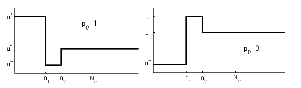

To lower the computational burden of the open-loop optimization, the family of admissible control sequences contains only sequences in the so-called pulse-step shape depicted below:
Note that each of these sequences is uniquely defined by only four numbers , and , where is the control horizon and stand for the given lower and upper limit of the manipulated variable. The on-line optimization (with respect to , , and ) minimizes the criterion
