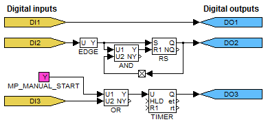

In order to help you speed up a start with REXYGEN and UniPi Neuron we have create an example project for all UniPi Neuron which is already preinstalled on the image with REXYGEN (installation is described in Section 3.1). The project serves as a basic validation of the installation process and as a starting point for more complex applications. One can control digital output(s) DO, analog output(s) AO, observe the state of digital inputs(s) DI and analog input(s) AI. These general inputs and outputs are present on all UniPi Neuron models. The steps to create and develop a new project from scratch is described in Chapter 6 in detail.
IMPORTANT: If you have valid permanent licence stored on your UniPi Neuron, this
project will start automatically once RexCore (REXYGEN runtime core) starts. Otherwise, if
you have only a Demo license, you must compile and download the project from
the REXYGEN Studio on the UniPi Neuron first. The project can be opened in the
REXYGEN Studio using either the procedure described in Section 5.3, or the project
can also be found in the Examples library as 0126-02_UniPi_Neuron_Generic (All
examples which are part of the installation are marked by an ExampleID. The most
up-to-date examples are available with the latest installation of development tools or at
https://www.rexygen.com/example-projects/ ).
The process of compiling and running the project is described in Section 6.2.

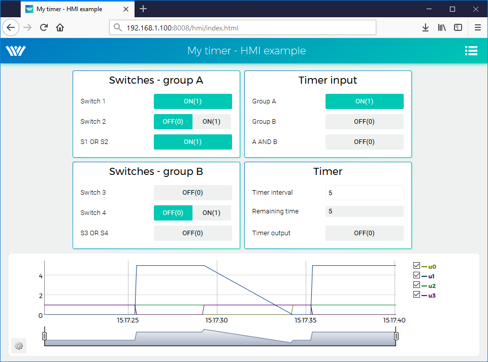

5.1 Control UniPi Neuron from HMI
The project contains graphical user interface (so-called Human-Machine-Interface) for easy control and observing of general outputs and inputs. The HMI can be found at URL address http://192.168.1.100:8008/hmi/index.html (replace 192.168.1.100 with the IP address of your UniPi Neuron).

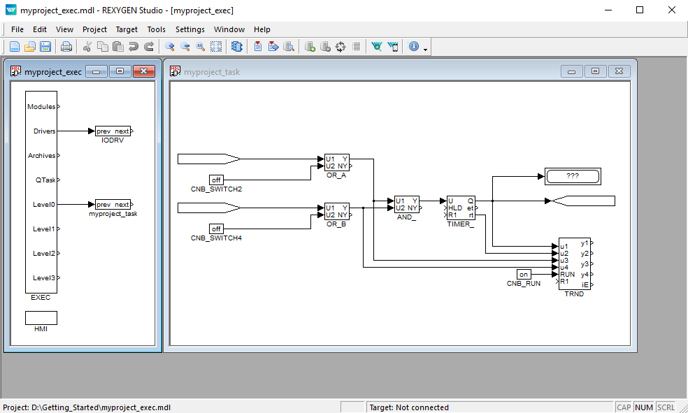

The process of creating a control algorithm will be demonstrated on a very simple example with four Boolean variables representing manual switches. In Chapter 7.3, two of them will be replaced by physical inputs of the UniPi Neuron. A software timer will be used for measuring the time when the variables are true (i.e. the switches are in the ON position). A Boolean signal will indicate that the interval of predefined length has elapsed.
6.1 Creating a new project
6.2 Compiling and running a project

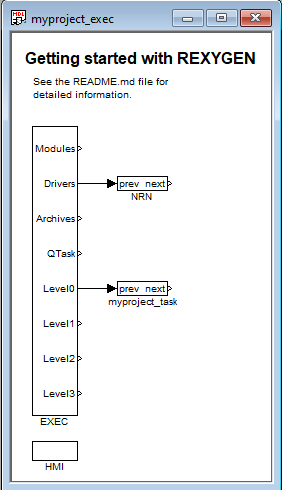

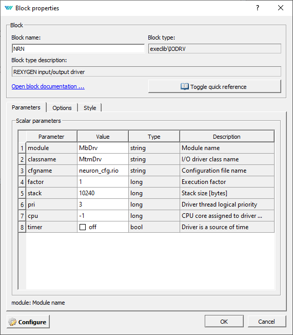

Now we tell the compiler to use the UniPi Neuron I/O driver. To do this, edit the IODRV block parameters. Communication will be mediated using Modbus TCP. Link the IODRV block with the MBDrv (Modbus) module by setting
- (beware, it’s CASE SENSITIVE!)
Continue editing the IODRV block parameters. For UniPi Neuron set the following:
As the final step, rename the IODRV block to NRN, which will serve as a prefix for all I/O signals of this driver.

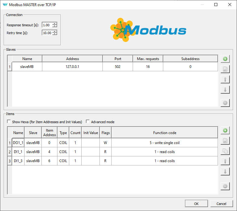

You have to create the neuron_cfg.rio file. Click on Configure button and fill the form as shown bellow. After that, click on OK and the file will be stored in the project folder.

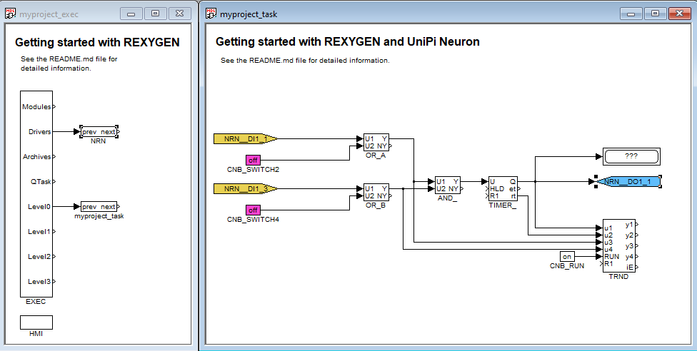

7.3.2 Modifications in the task

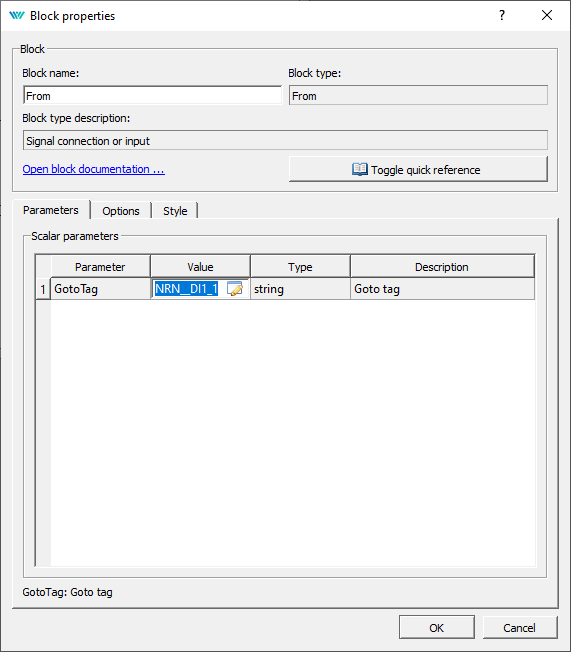

In the task double-click the input flag and set . Note the NRN prefix and two underscore characters. The first physical switch (SW1) is connected to first group of Digital Inputs - input 1.
The other physical switch (SW3) is connected to Digital Input 1.3 (NRN__DI1_3). The last (Digital Output) flag will be set as
After compiling the project and downloading it to the UniPi Neuron the control algorithm interacts with the physical world. Again it is possible to switch to Watch mode and observe the signals in real-time or analyze the trends of signals. Flip the physical switches and watch the signals.

A detailed description of the Modbus TCP IO driver which serves as communication platform for UniPi Neuron is available in a separate manual [6].

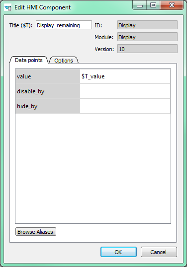

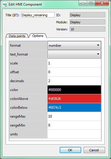

Chapter 6 describes the creation of a simple WebBuDi user interface. The REXYGEN development tools also contain the REXYGEN HMI Designer program which is a tool for designing custom graphical visualizations from predefined components (Definition of custom components is also possible but it requires a bit of Javascript coding.). The REXYGEN HMI Designer is based on the well-known open-source vector editor InkscapeTM https://inkscape.org/en/.
You can find the description of each component and property in [5]. Leave the default values
The Browser requires a target device with running algorithm. Make sure the algorithm is running, see Section 6.2. Also the target URL must be set. Press Browse button. The login dialog will be opened. Change Target to 192.168.1.100:8008 (replace 192.168.1.100 with the IP address of your UniPi Neuron). Unless you changed the login credentials, use the default username admin with an empty password. After a successful login the connection tab is expanded with a tree-view of the running algorithm (you have already seen this tree-view in algorithm diagnostics).
As mentioned earlier, the *.hmi.svg files in the hmisrc folder are automatically processed while the project is compiled in the REXYGEN Studio application. The project main file must contain the HMI block with GenerateRexHMI parameter enabled. This was already covered in Section 6.3 so you should have everything ready.
Once you compile the project again and download it to your UniPi Neuron, the HMI will
be accessible via a web browser. Navigate to
of your UniPi Neuron). You will see your HMI with live data.
